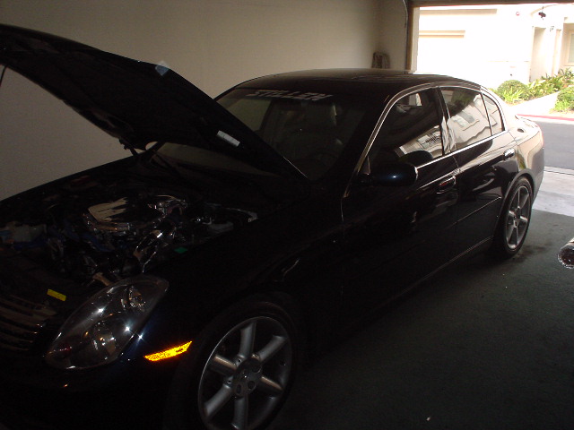

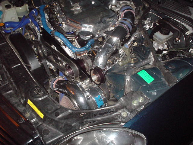

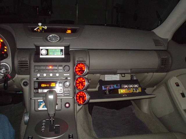

I did the vortech w/ the whole works of add ons.. Fuel, HKS ECU, plenum, methyl injection, headers, y-pipe, full exhaust, valve body, and many more.
I pulled 365WHP, 330WTQ, at only 7psi on a mustang dyno. Very low boost for the vortech. Stock on the kit is 8psi. I also have a automatic. If you have a manual it will help the numbers.
Attached Thumbnails Vortech Owners-g35.jpg   Vortech Owners-gt-motorsports-035.jpg   Vortech Owners-gt-motorsports-033.jpg

What kind of gauges and gauge pod? Looks great.

Wow some nice numbers Im seeing. Thanks guys. to be honest, my goal is 350whp, with a conservative tune, and eventually upgrading stuff like injectors etc.
Sickg35, your engine bay looks delicious.
