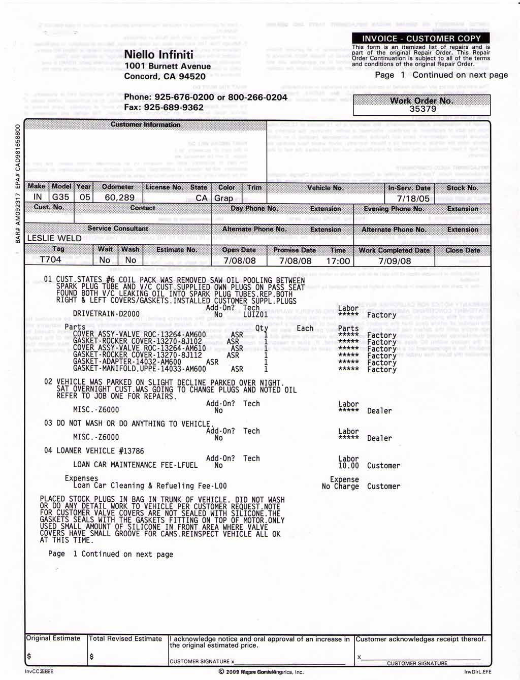

Hey, i have a 2004 with extended warranty original owner, etc....
my dealership said when i bring it in i need to remove all EXTRA mods any mods relating to engine will VOID warranty if related! This problem you are having is not related to any mod tho. It is a very common problem with the g's and z's. But even an after market AEM intake they told me would have voided my warranty when my MAF sensor took a ****... had nothing to do with it but anyway... TAKE EVERYTHING OFF!!!! Do not bring it in without TAKING IT ALL OFF or your warranty is ****ed and that job is about a 500$ job b/c they will replace both valve covers, etc... here is a copy of my friends reciept from his dealer....

You will need to remove everything! If they find any indication of aftermarket parts...especially nitrous the warranty will be voided since your direct actions may have caused the damage to the vehicle. There are some exceptions to this rule like an aftermarket air filter (probably not a complete intake). The rule is that the dealership has to prove that the aftermarket part caused the damage to the vehicle. Read the Magnuson-Moss act as it was designed to protect the automotive enthusiast to a certain degree. It would be very easy to diagnose that the nitrous caused the oil to appear on the plug by somehow damaging that cylinder. Good luck fooling the warranty system.

They can't just void your warranty. They have to PROVE that what you did caused damage. So find the source of the problem before you take it in. If your nitrous caused the problem, then yes they will not fix it. Don't let them scare you into thinking you're screwed. I have warranty work done on my car every once in a while, and they never have complained about my mods (see sig).
