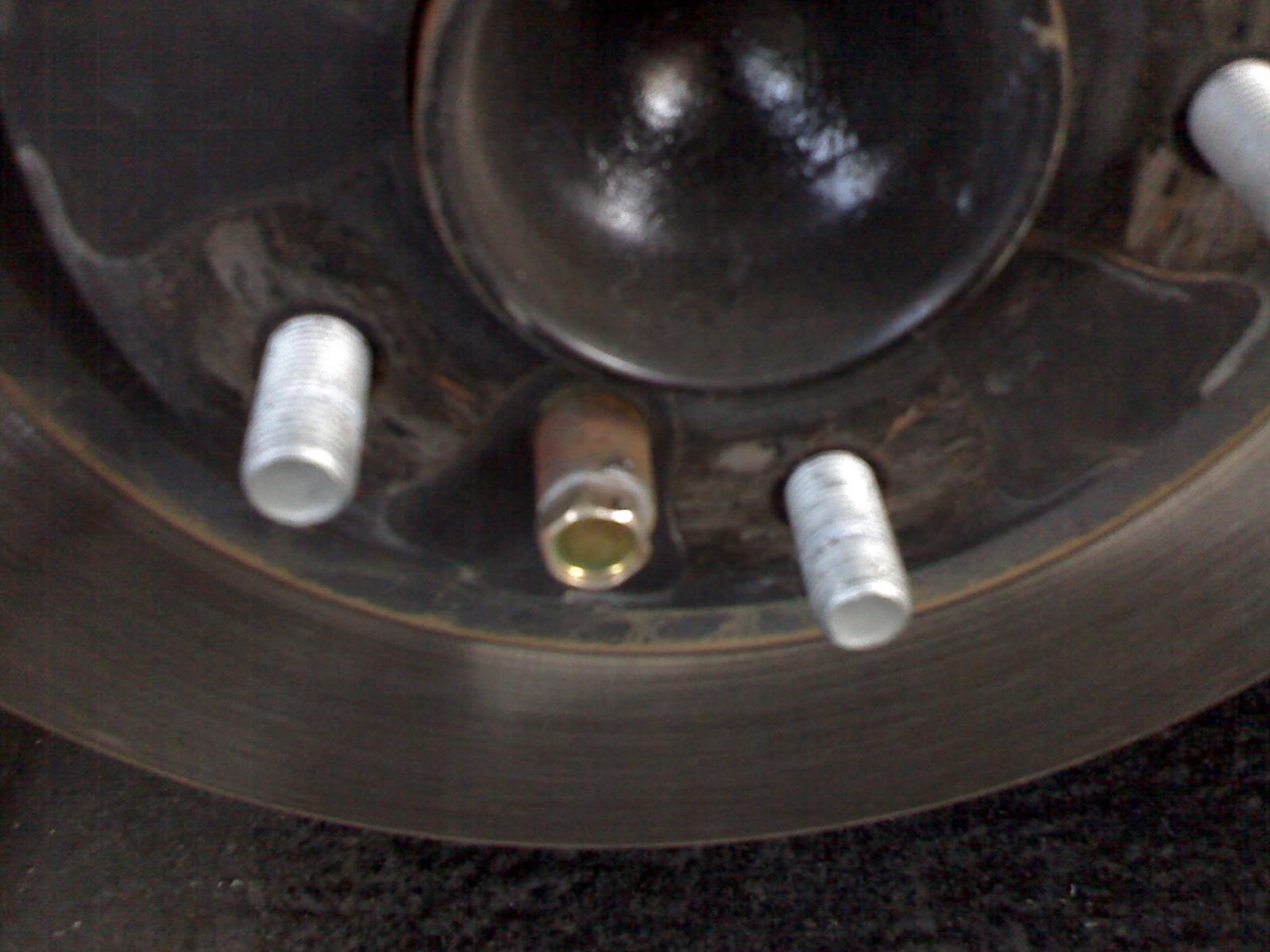

wheel hub. I was putting on my new rims and tires. I changed the back one with no problem, but when I got to the front I notice a extra stud or peg and cant fit the front tire on. I have read that it is just a stud so that the factory wheels do not get rotated. Can anyone help me with this. I have put a pic so you can see what I am talking about. Thanks

Someone just asked this recently.. but I know it's probably hard to search for something like this.
yes, it's safe to remove, don't worry about it. It is as u say.

Just take it off, it's just to prevent you from putting the oem wheels on wrong!

Thanks everyone. I took it off and put my new wheels on. No problems yet other that the TPMS went on. Just need to figure if there is a way to disarm it now.

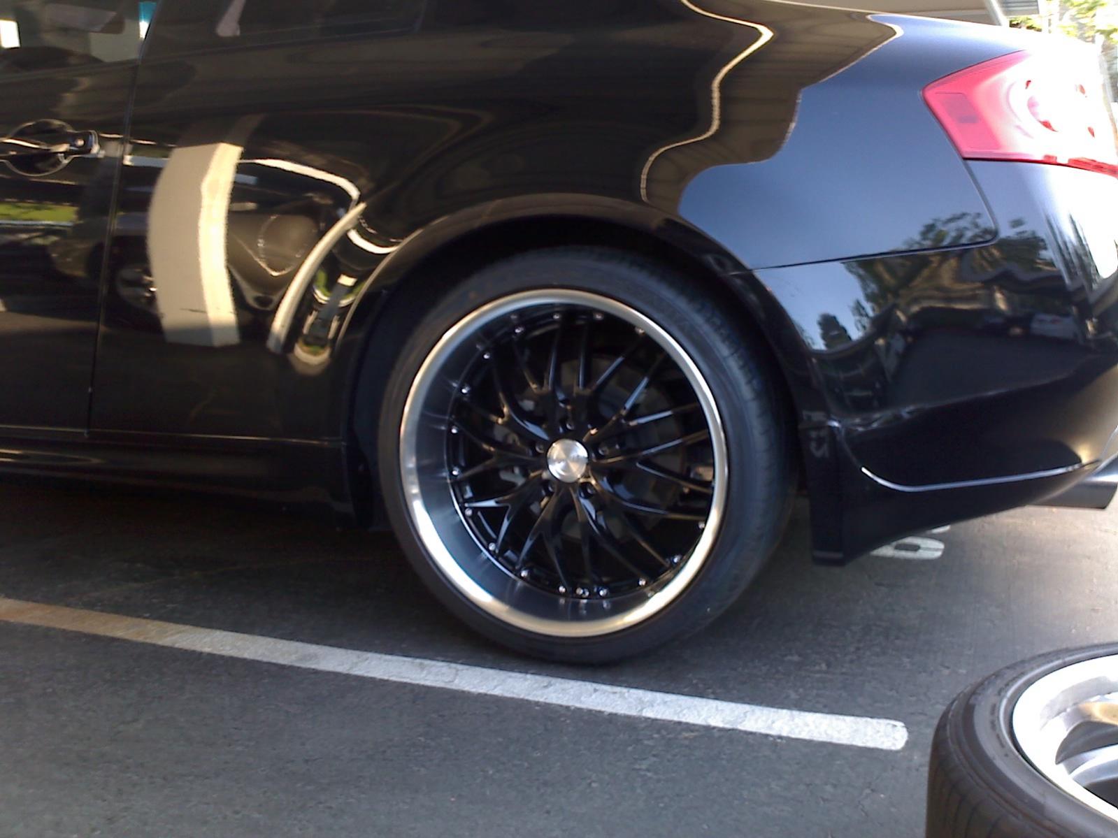

Old Jul 6, 2020 | 05:04 PM
Jeff Michel's Avatar
Joined: Jul 2020
Posts: 2
infiniti G35 coupe
Having the same problem
I’m having the same problem where I have an extra stud is it really safe to remove it and won’t affect the performance of the car. If so how do I remove it
Old Jul 6, 2020 | 05:23 PM
Scorpi0's Avatar
Joined: Feb 2018
Posts: 3,087
Likes: 445
From: LA, Cali
Yes. Its a bolt head, just turn it with a wrench.
Old Jul 6, 2020 | 06:07 PM
Joined: Jul 2020
Posts: 2
infiniti G35 coupe
6th wheel stud
sounds easy enough so I won’t encounter any future problems due to me removing this extra piece

The 2003-2004 coupes for sure had different size tires in the rear than the front. Two of the stock rims had a relief hole for the extra stud to nest into. This was to prevent mixing the tires from front to back and vice versa. For cars equipped with the 18" wheels the rims were the same size, however the 17" rims had a different offset in the rear than the front. so the extra stud prevented them from being mixed. If you are replacing the rims with aftermarket, you can remove the extra stud, just make sure they don't interfere with the brake calipers.
