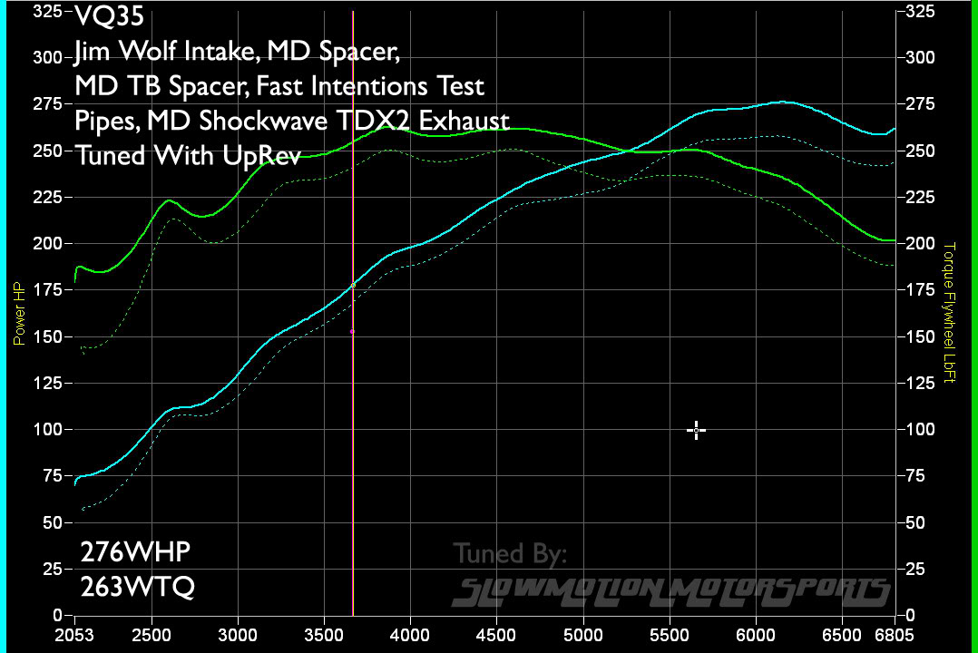

I just got tuned today and ended up 276hp/263tq
^proof
