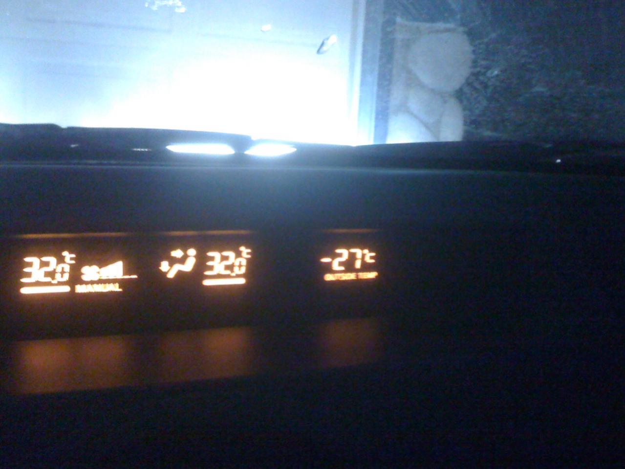

New to the forum and cognizant of not wasting time but I could not resist. Look to the far right on the pic. FYI - that translates into -17F. Had to put on a long sleeve shirt today damn it!!!!

You must live in Alberta? Similar tempatures here the last 2 days?

Thought maybe I'd have to wear shoes instead of flip flops today, was just a thought though.
