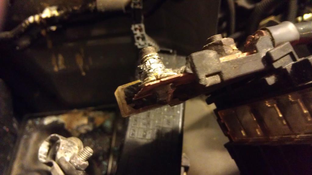

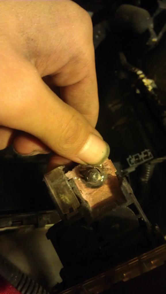

Ok on with the story...My friends and i had a car meet and it was 6o clock. It was getting dark, the photographer couldnt get any good pics because the flash made the pics look bad. He decided that we all turn on our headlights. 30-40 minutes later i closed the lights and when we were about to go eat....I cranked my car and the engine wouldnt turn over. A fiend lifted the postive terminal jump my car and saw the blue invasion! Next day, i bought a new battery and terminal protector. As i unscrewed the positive, the clamp snapped. Ohh shizz....and there is a fuze connected to it....ohh shizz. Now it too like nearly 3 hours to dremel off the nut because the corrosion made the bolts rust. Also it was impossible to take off because there was no leverage to use full force. If you hold onto the fuse, then too much stree would be put upon it. Now i need to buy a new terminal and am planning to spray like 10 coats on it. Im also going to check my battery more often because this is so stupid. I have no clue why they could put the fuse elsewhere like older cars like hondas.... so much easier.
This is what i did. If anyone has a better idea, id be happy to hear so i dont have to waste my time haha. Also 5 mosquito bites now -_-
