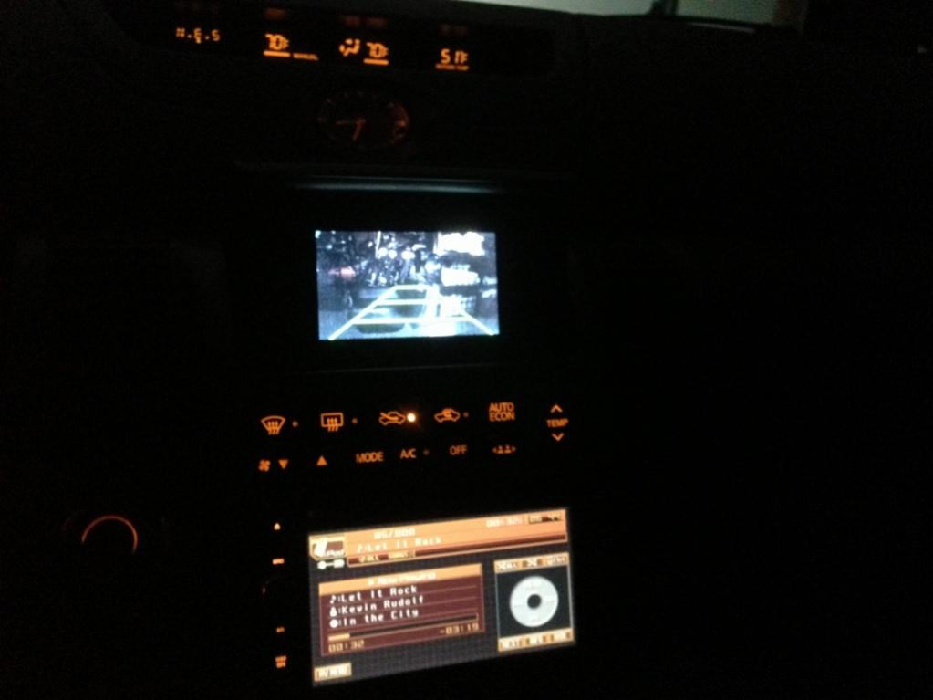

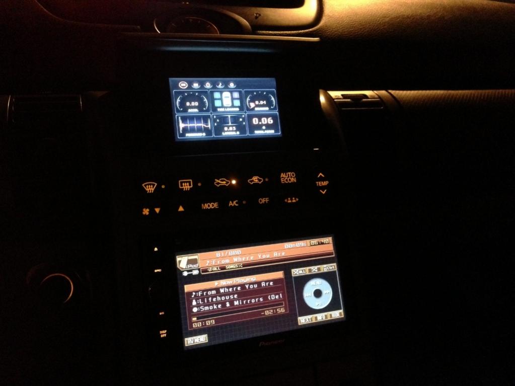

Hey all, I'm on the tail end of a vacation, finally at home, and with weather warming up and nothing on TV the mod bug bit me again. Girlfriend is back at work so started getting bored of Sportscenter and PS3.
I installed my double din last year, and since then, the one thing I've hated is how I have to crane my neck down to see the rearview video feed. I have the non-nav version of the car, so my cubby is empty and useless most of the time. My solution was another video monitor. Got the following supplies:
-Monitor with a voltage sensing input ($20): http://www.ebay.com/itm/4-3-TFT-LCD-...item43b96a6b81
-6"x6" piece of Lexan from Lowes: $2
-black spray paint, epoxy - found in garage
Next used a dremel and epoxy to shape a piece of plastic that fit perfectly in the cubby. Measured and taped out a cutout the size of the monitor, and painted the back side of the lexan that was not exposed to the outside. Attached monitor to back side of lexan with epoxy, mounted in cubby, ran power from switched 12v so monitor would turn off when key is out of ignition. Nice thing is the monitor has 1 voltage sensing input, so backup camera turns on, triggers monitor to switch to that video input, and switches back to another video input when you shift in and out of reverse. Nice, no more craning my neck and no more pressing "rearview" camera on my headunit to bring the camera up. That's the productive part.

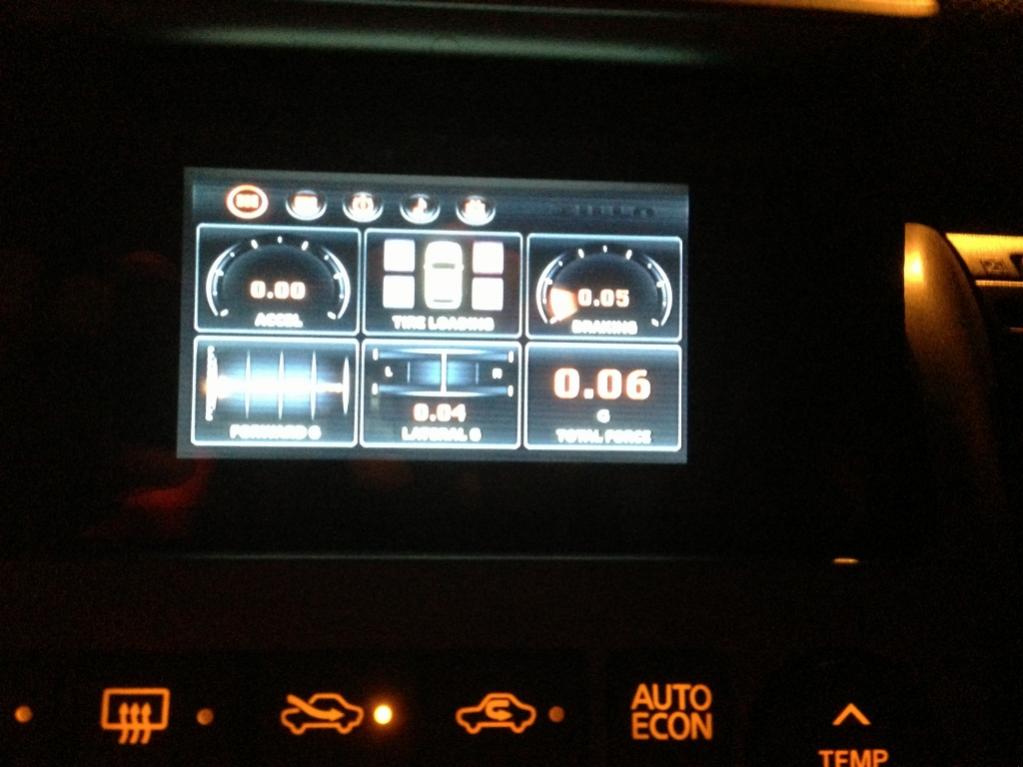

Now for the more useless part. With the extra video input on the monitor, I wanted the screen to show something besides just a black screen when I'm not in reverse. One thing I always though was really cool was the GTR's accessory dash display showing speed, gyro, etc. Had some change left on my itunes account, and when to find an app that kinda did that. To my surprise, I found the app "Zilla". It looked like the GTR screen; and was $3 buck so what the heck. I tried it out, and for another dollar it gives you different color schemes, including an orange one that matches the OEM interior lights. My iPhone is jailbroken, and I can output to an external display the devices' display. Got a composite video cable from Apple store that also charges my phone and the pictures below show the result.
Now, even though my Iphone's gyro is pretty sensitive, I don't believe this to be accurate enough to use on the track, etc. But, any app on the iPhone can be displayed, including the Google maps with navigation app that I love. My double din is nav "capable", but I'm not gonna spend more money adding different modules and what not. Overall I think the second screen is pretty useful; and hey, if my iphone is already gonna be hooked up charging when I'm in the car, this opens up alot of possiblities of other uses.

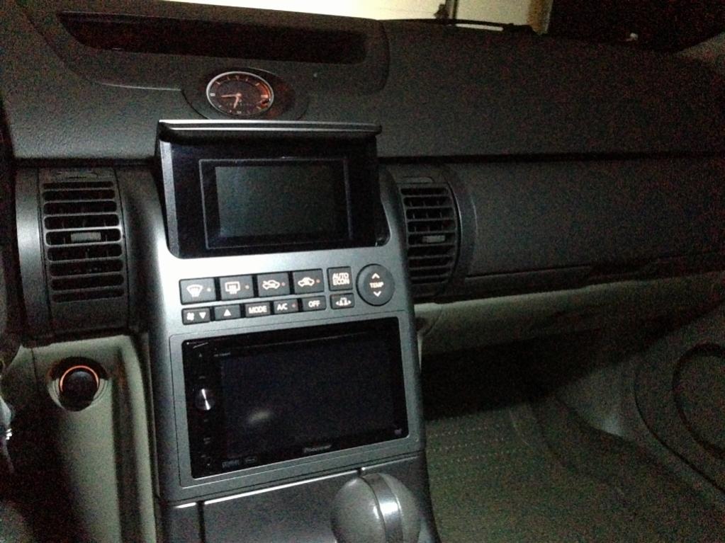

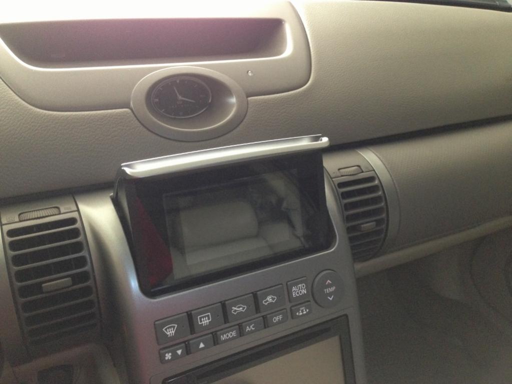

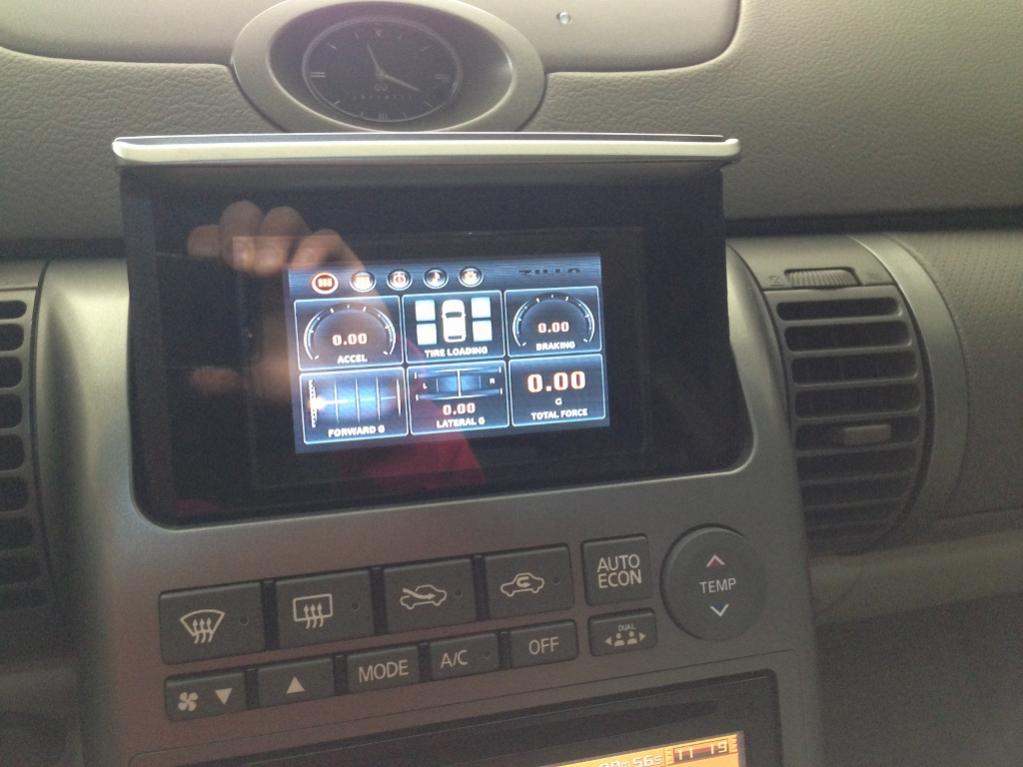

Better daytime pics included below.
Original cover is still there, the panel fits between the underside crease of the cover and the wedge of the cover recess. I am thinking about making a spring loaded hinge so I can close the cover, but that would mean going back and redesigning the sides of the panel to allow for the panel to collapse into the cubby. Also, I only made 1 tiny hole in the the nonvisible (rearfacing) side of the cubby to allow for power and video cables, and putting a spring loaded hinge would mean at least 2 bolts into the cubby cover (not really wanting to mess with the cover right not). At least for now I'm happy with it being up all the time.
I have one of the older Pioneer DVD units that doesn't switch automatically. Between pressing that button and having to look down, the backup cam was pretty much unused until I put the upper screen in.
