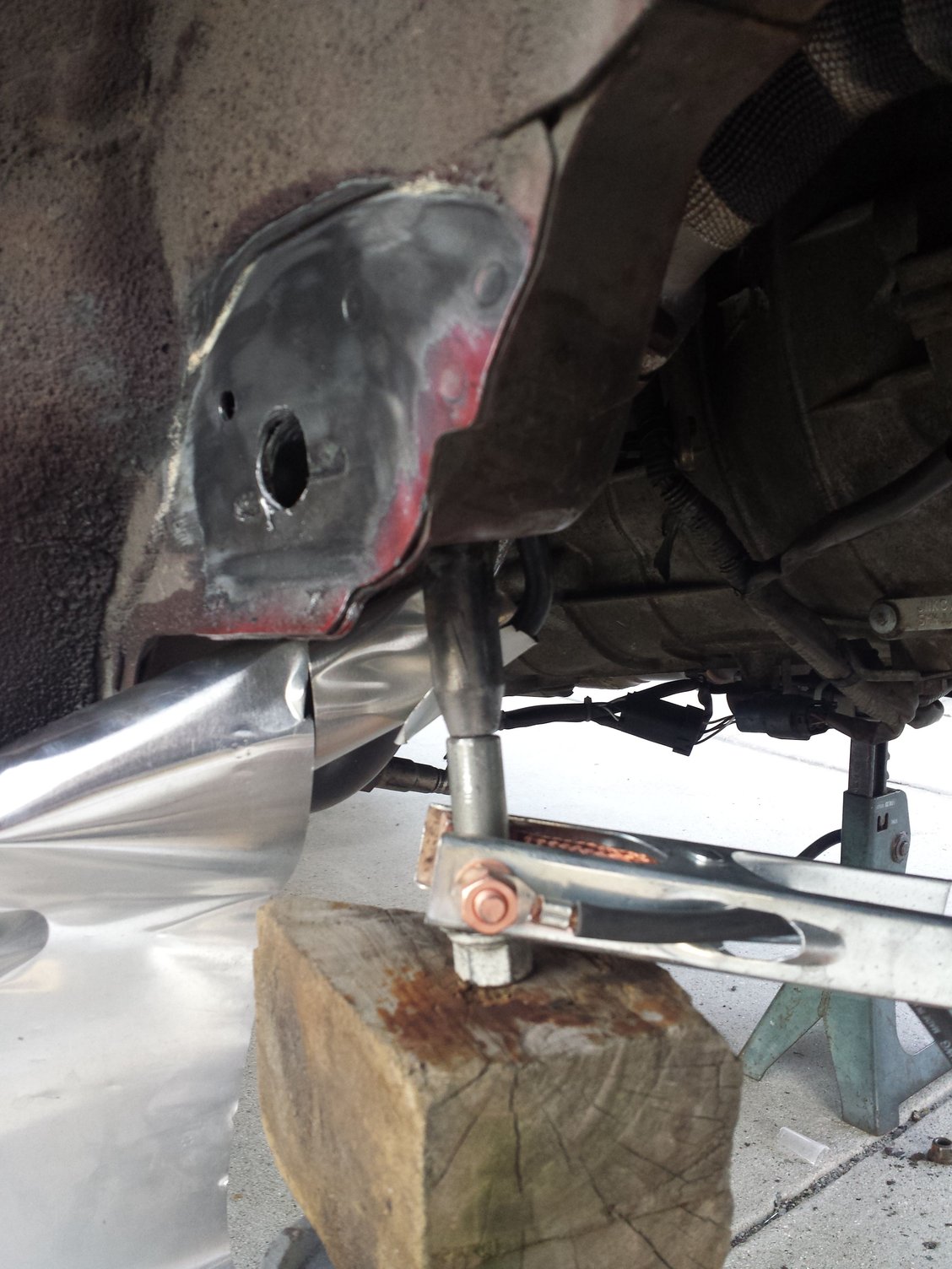

the answer is: yes, no and this break could scrap your car. It is attached to the frame rail and not removable.
in my case it was corroded and snapped in 2 when I was removing the nut for the compression rod stud. The bushing sleeve was seized to the stud, and the bushing was so bad that I just twisted the arm till I could pull it out. Then I hammered and pried the bushing from the broken stud. I found a similarly sized bolt and nut and cut and welded them into a new stud. Not every driveway mechanic has this capability though, so be warned before you do this job. It can get bad. I just got lucky that I had a whole box of bolts for the last decade from stripping cars to race.. Nissan, Honda Mazda, BMW, Porsche..its all in there..The Magic Bolt Box.. never fails.
Pay no attention the access hole I drilled thinking it could use a nut and bolt if I removed the stud. It goes all the way thru the frame!
Not pretty but she's strong.
Best of luck to you.
