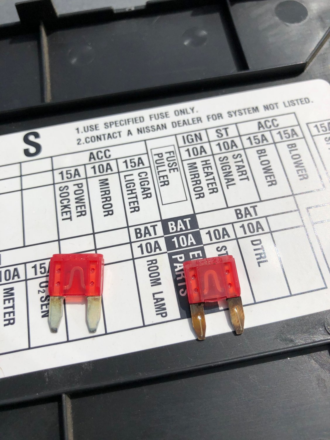

Obviously really late response, but I literally just FINALLY (after 2 years and thousands on parts and having Infiniti + various other mechanics try to find out the issue) figured out why P1283 wouldn’t go away and I’ve changed every o2 sensor and every a/f senors on the car & MAF as the most obvious culprits I thought)... Anyway I’ve been reading the threads on since I got my 04 G sedan 2 1/2 years ago with 170k, now it has 212k ... yesterday I randomly found an article that said to reset the ECU (I’ve done this only the battery way and the pedal dance) I was totally unaware the ECU has two fuses, take both of them out for 10 min and put them back in and ECU is completely reset. I thought I’d give it a shot instead of paying Infiniti $700 to fix it... I took both fuses out, BOTH FUSES WERE SHOT!!
I swapped them out and problem solved.. been over 100miles and still no CEL, and not to mention my MPG has literally doubled. I was just about to drive my G off a cliff too!
Fuses either work or they don't work. There's no "not working optimally" or working poorly. What do you mean they were "shot" ? If both fuses were blown, i.e. "shot", your car won't run.

Sorry, my verbiage probably isn’t up to par.. I stand corrected, one of these was probably still working which would explain why car was still running, but either way it was a simple fix.. hope this helps...!!
One on the right is the fuse that’s under the hood... replaced it with a slightly better one on the left.
One on right was fuse inside car.. replaced it with the one on the left.
HELL WHY NOT?
I'll be checking my fuses soon, I've exchanged many sensors. I've litterally learned resistance between cam and crank sensors, sealed intake manifold, measured injectors, measured and replaced coils along with upgrading the stalks. Changed an AF sensor and blahhh.
That is a weird issue. From what I can see it could be due to contamination (fuse boxes are not in an ideal location) or could be that it saw a period of high amperage, just not enough to burn it that it carbonized it.

As badly corroded as those terminals (?) were, yeah, that could cause intermittent or continuous issues.

It amazes me electrical connectors don't show up from the factory with dielectric grease in them. This is what the lack Thereof causes...

The IPDM was supposed to be a dry location though, however it turned out to have a very fatal flaw in the cover being difficult to completely seal up and the cowl drains were prone to getting clogged with debris.
Basically a perfect storm of engineering flaws, however I completely agree that aluminum bladed fuses should have anti-oxidation grease applied to them.
