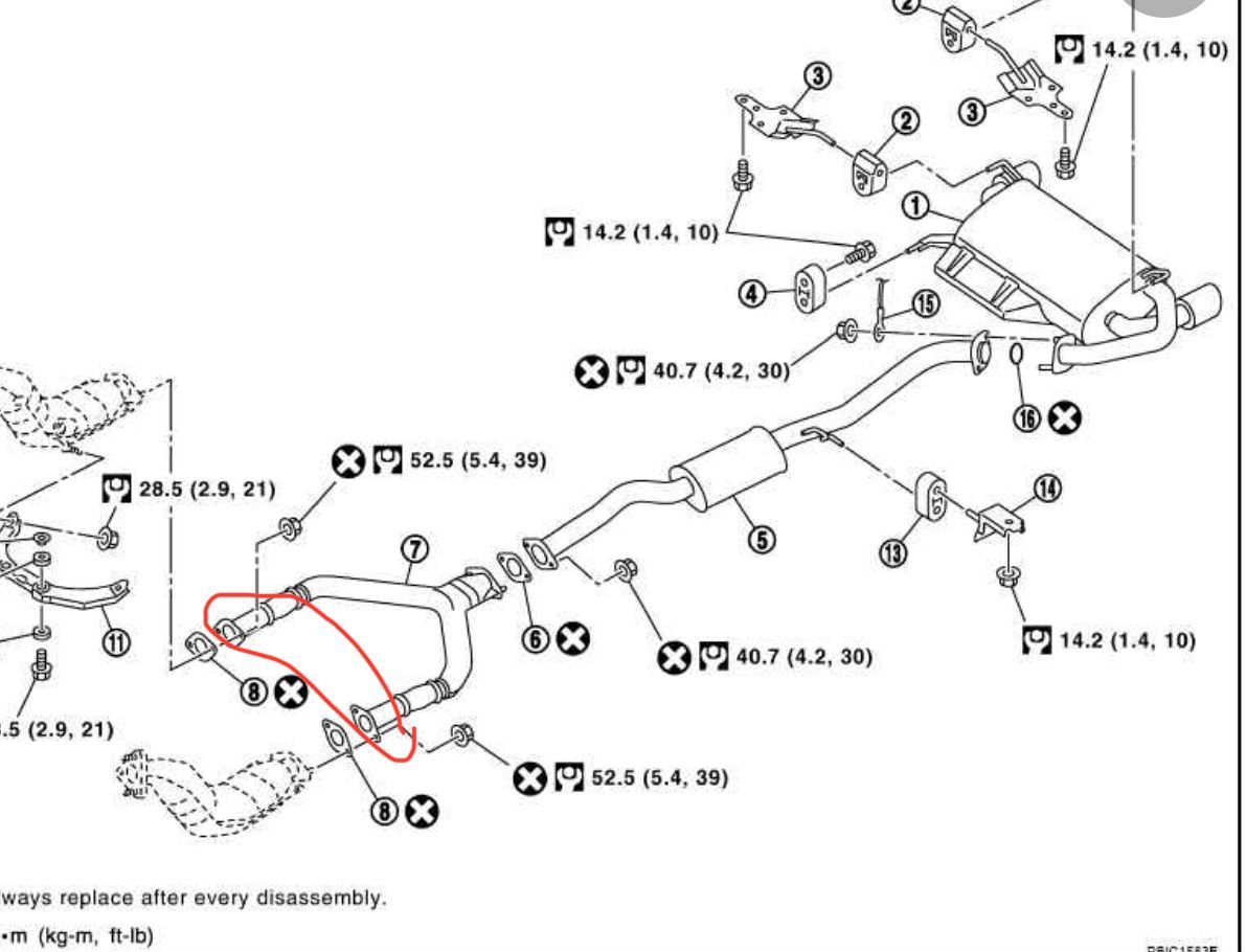

Originally Posted by OnemeanG
They took off ur cats to do the clutch? And tried to remove exhaust manifold too?
nooo I do not have cats lol
where I circled is where they were attempting to disconnect it
Where I have circled in red is where they were trying to disconnect it lol they struggled a lot to get the bolts out but once they did it still would not disconnect lol

Ohh the y pipe; that’s weird. I just did my clutch and struggled to get most the exhaust nuts off but once the nuts were off the exhaust slid right apart. 95k on my g
Yeah idk! Lucky you lol I’m at 262k 😂
Old Jun 26, 2021 | 04:10 PM
cleric670's Avatar
BANNED!!!
Joined: May 2017
Posts: 14,837
Likes: 2,497
From: Washington State
Coupe 6MT Premium RAS
Yeah the shop just didn't know what they were doing. Even if the y-pipe bolts were fused into place and needed to be air chiseled or sawzalled off it's not that big of a deal, drill out the existing bolt holes in the cats/test pipes and put in new ones. Not a big deal.
Anyone who would leave the y-pipe in place and try to do the clutch with it in place is almost definitely not the shop you want to be taking your car to for repairs.
They could have gone upstream a little and just unbolted the test pipes from the headers and left them attached to the y-pipe, there's plenty of options to give you the room needed to get the tranny out properly.
