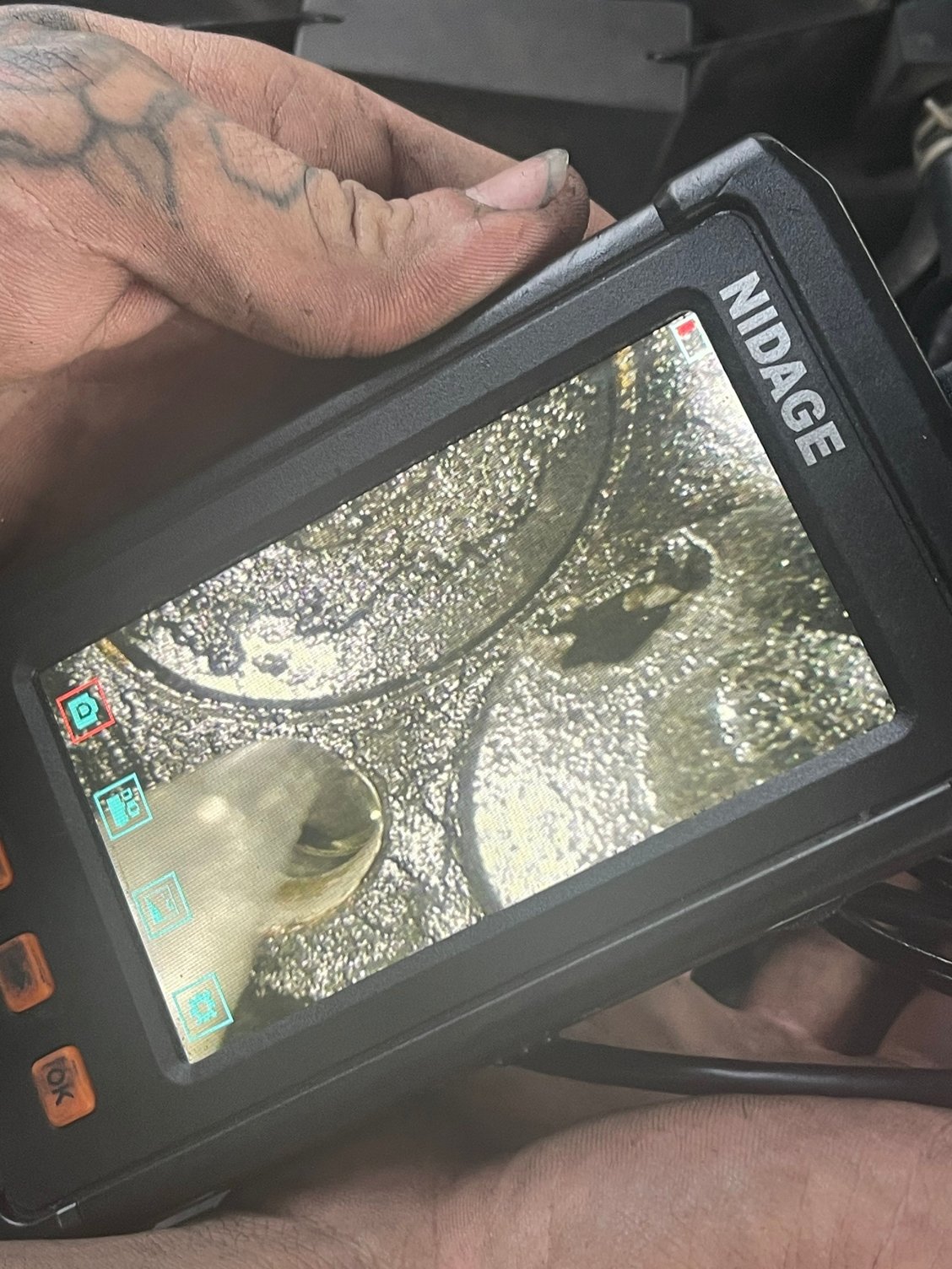

No my ecm is fine
wanted to give you update lol it’s burnt valve. So now I’m just gonna part out the car and buy another one I found a super clean 04 with lower kms and no rust imported to Canada from Texas or florida going to see it next week

Wow damn, that's not common damage on a VQ, was this engine ever on some kind of forced induction? SC, turbo, nitrous?
Old Oct 8, 2021 | 10:00 PM
Aggyvq's Avatar
Joined: Jun 2021
Posts: 25
From: Canada
G35 rev up coupeeeee 2005
nope not that I know of. I personally think it was my tune. It really sucks!!
