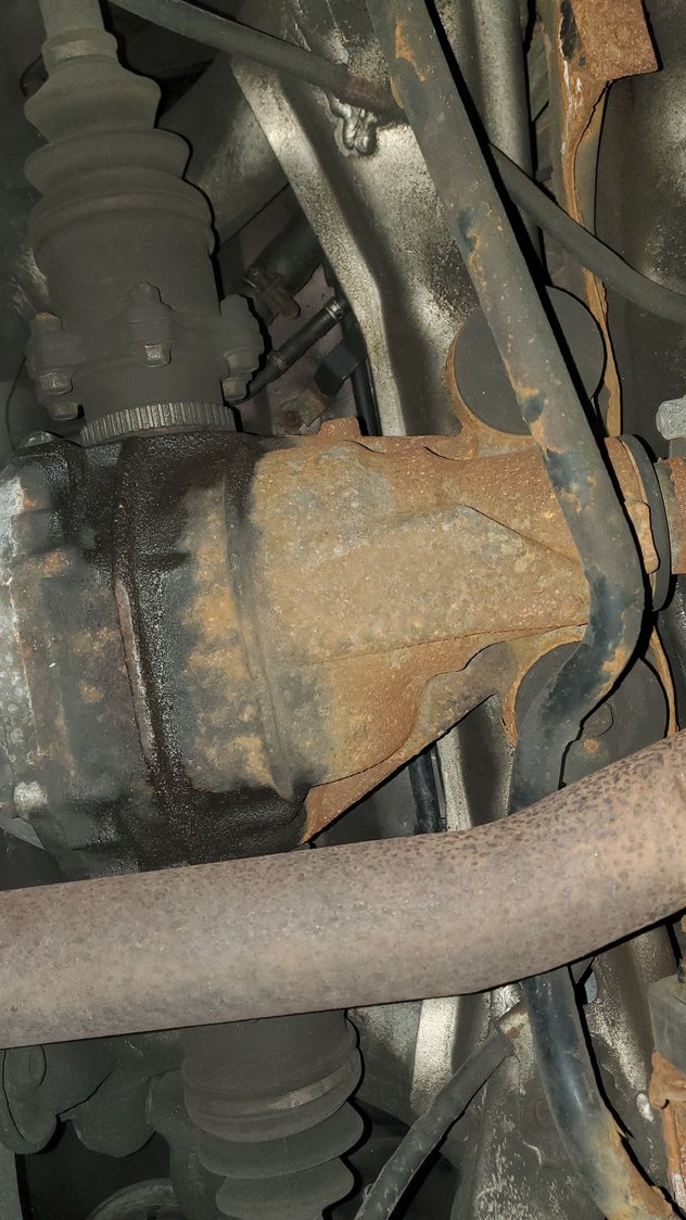

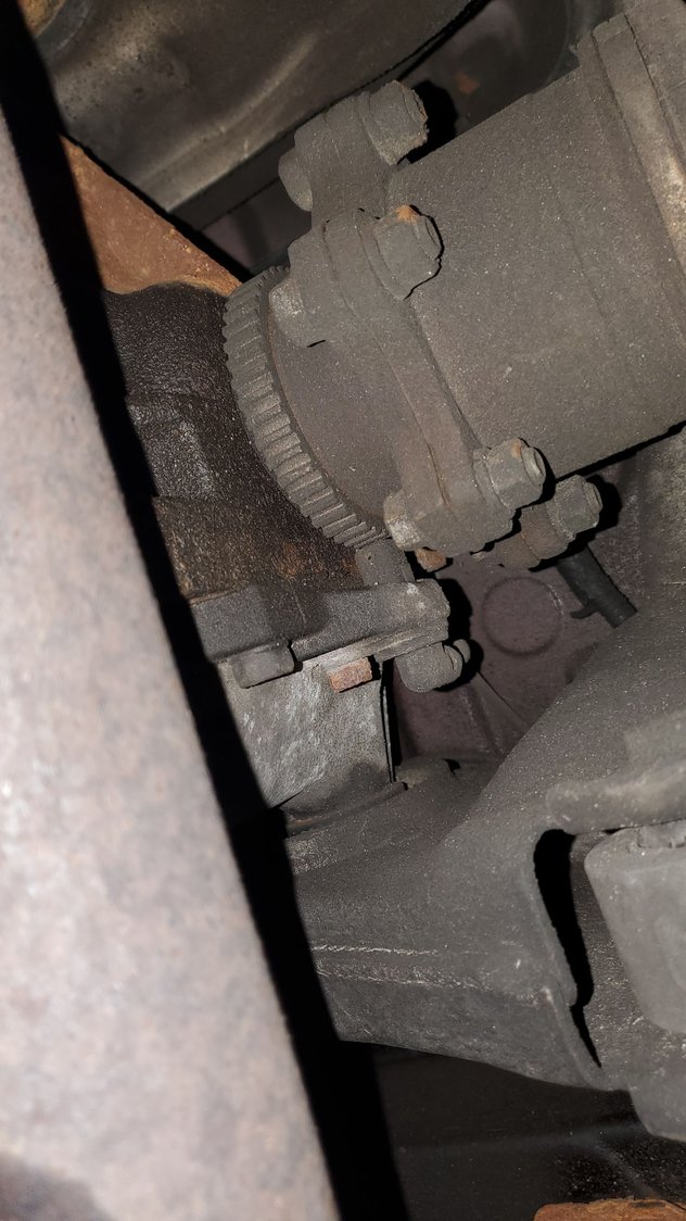

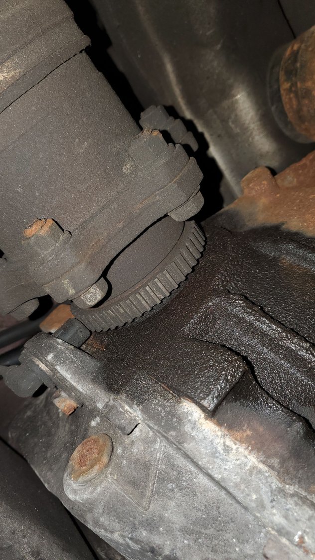

Hey folks,
Anyone ever experience this?
I assume the fluid in question is diff fluid? or grease from axles?

It's from the seals for the stub shafts on the differential. This happens when the differential isn't ever maintained, basically you end up with a lot of metal in the gear oil in differentials, if you don't change the fluid to remove this metal it ends up destroying the seals as the metal glitter rubs on the rubber seals.
If it's not DRIPPING on the ground I would just change the diff gear oil and call it a day.
Maintenance interval for the differential is every 30k miles.
