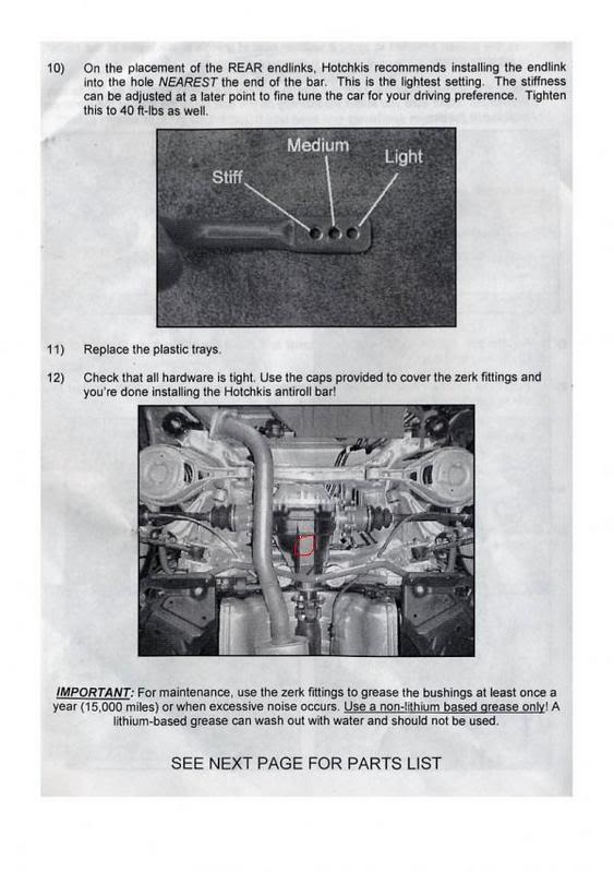

Raised the car today... that's where i put the floor jack... is it the correct place to put the floor jack?
I saw a white colored dot there so I centered it there.
Pinch welds didn't bend with the jackstands bythabay recommended. Probably because I sort of left the floor jack under the circled part.
