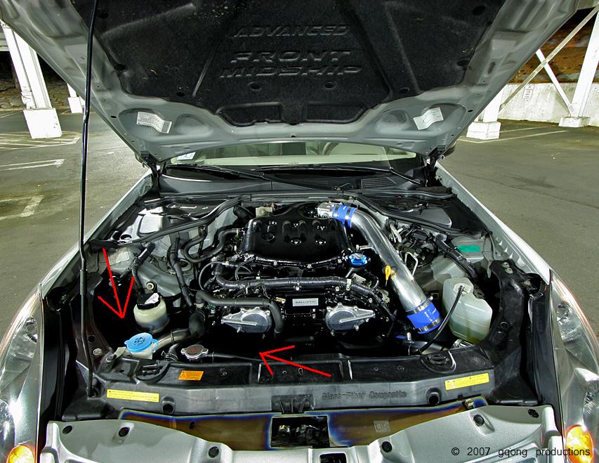

The ARC can (horizontal version) is usually mounted in front of the engine bay. Most FI'ed cars have the intake part that is bolted to the fiber composite material off so that is a perfect spot. Mine (Greddy vertical) is being mounted on passenger side next to the power steering fluid. Hope that helps
Attached Thumbnails What oil catch can are people using with the best success?-catch.jpg

When I was NA, I had mine mounted behind the driver side headlight next to the intake. Now that I have a Vortech it's on the passenger side next to the power steering reseviour.

So the Greddy will fit next to PS reservoir without moving reservoir to the right on it's mount brackets?

Did you ever get your Greddy mounted? If you have, mind posting a close-up picture of it?
I'm still having a hard time visualizing exactly where/how to mount in reference to my engine bay pictures.
