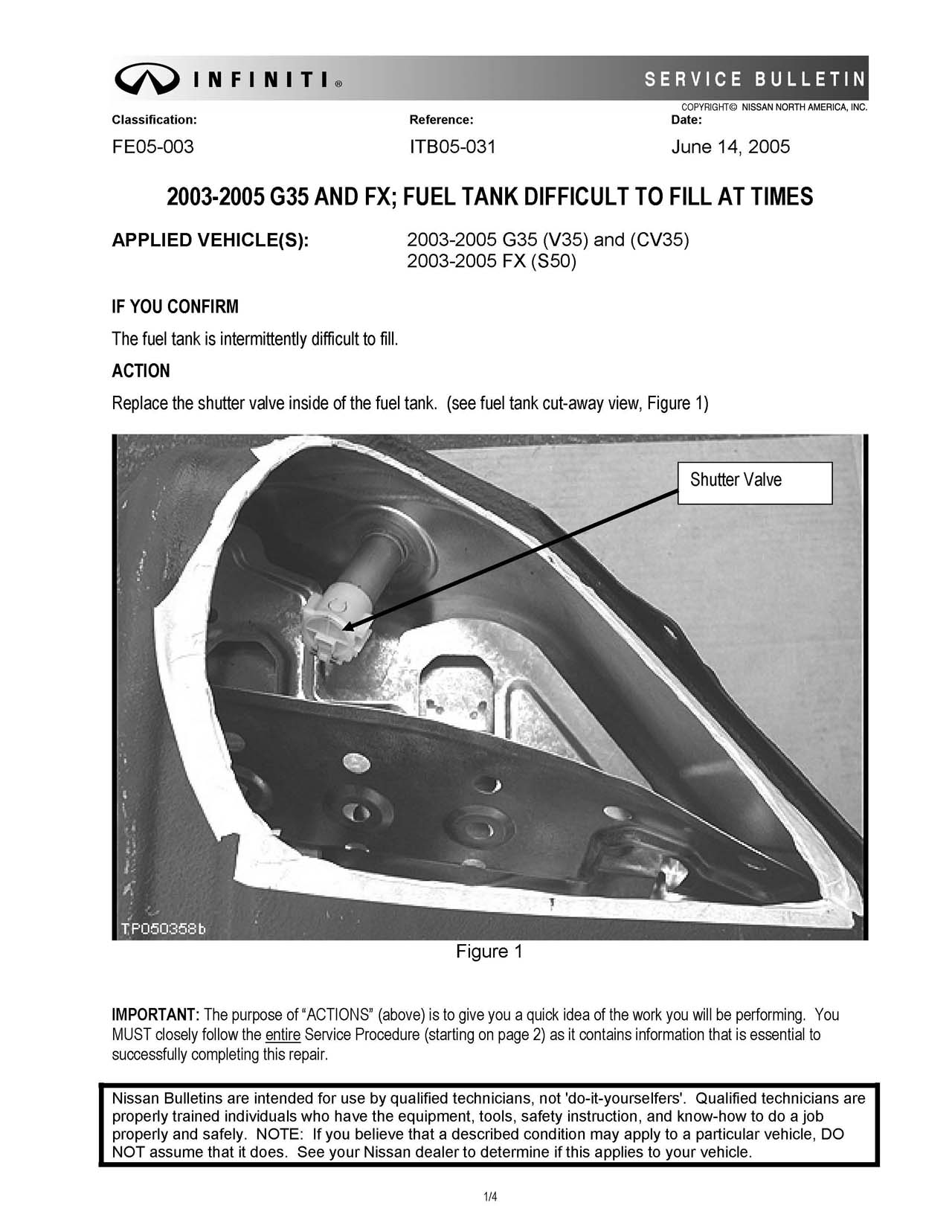

sounds like u have a bad flapper. i had mine replaced twice when i had my car... problem always seemed to come back. there is a tsb out for it.
Attached Thumbnails My Gas Gauge is messed up, and my car is a pain to fill up.-itb05-031_page__1.jpg   My Gas Gauge is messed up, and my car is a pain to fill up.-itb05-031_page_2.jpg   My Gas Gauge is messed up, and my car is a pain to fill up.-itb05-031_page_3.jpg   My Gas Gauge is messed up, and my car is a pain to fill up.-itb05-031_page_4.jpg

shutter valve for you fueling problem, your gas guage can either be the combination meter (gauge cluster) but is more than likely the fuel sending unit.

As for dropping the tank and replacing the sender, you don't have to, there is an access panel under the rear seat (pass side). Start your car and then remove the fuel pump relay, the car should die. Continue cranking the car until it no longer attempts to start (this should release fuel pressure in the lines). Remove the lower rear seat (two tabs, one per side, they pull out and you push seat up) once that is removed you'll see the access panel. use a flat blade screwdriver to pull the cover off (turn the tabs clockwise to remove) and disconnect the harness, remove the 8mm bolts and vola, theres the fuel pump and sending unit. Be sure to get the o-ring for the pump/sender, peace.

you will love these solutions. if you can't fill up correctly either your fill neck or your fuel tank has to be replaced. i had my neck replaced 3 times and my fuel tank twice because the baffles were defective somehow. your fuel sending unit will have to be replaced if it doesnt read full ever. let me know if you need help getting parts i can bring or ship them when i come to va next month.

Update: the part numbers are the same, the 350z had the same itb on it. Part number for the valve is 17260-am600, the o-ring is 17342-ce800, hope that helps. As for the relay, i think theres a fuse for the fuel pump in the ipdm you can pull.

both are relatively easy fixes actually, the flapper valve is in the fuel tank, if you remove the sending unit (as stated above) you can actually fish the valve out and replace it while you're there. its behind a metal shield toward the rear of the tank (aprox area is under and to the rear of the access panel) it twists off and the other one twists back on. Yes this might involve getting gasoline on your arm, but its better to have gas on your arm for 5 minutes than on your paint or shoes if the valve sticks open or shut.
