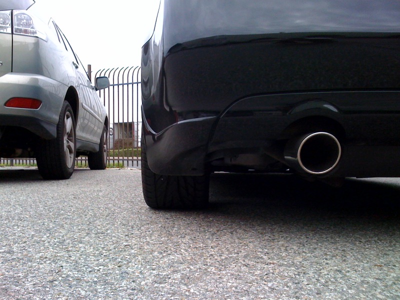

Originally Posted by KhanArt
Is this on the oem 19' wheels? how does it ride? can you post some pics of this setup?
Yea they're on oem 19's. You can definitely feel more of the cracks and crevices of the road but it doesn't brother me as I prefer the overall looks of it. Not sure what you're looking for so I just took a shot of the sidewalls and one from the rear.
I was trying to see if it noticably looks wider in the rear, thats the only reason I would want to go wider is for looks. kinda hard to tell from the pics but thanks for posting.
post pics of the rear from a little further back bro so u can see how wide both rear tires are from the rear.
Yes if you can post more pics that can really show the effect of the wider tire would be appreciated.
