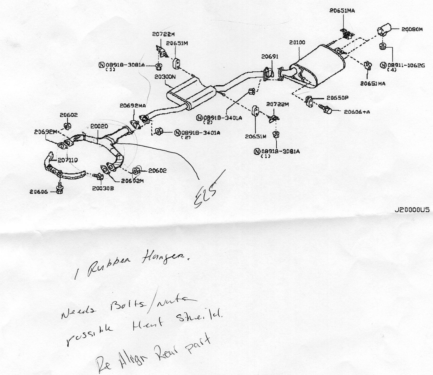

This is the part they told me i needed. Does this catback exhaust system have that part in it?
http://cgi.ebay.com/ebaymotors/03-07...sories?afsrc=1
the part number i need is 20020

yeah i saw your review and it was excellent, is the part i need called the Y-pipe and if so, is that included in the cat back exhaust system that i want.
The mechanic at Midas told me that that part was severely stretched out and he showed me. The brackets that hold the exhaust are not aligned anymore from the exhaust as the exhaust is now only holding on to its life by one bracket.
Sorry for all the questions but iam not too smart when it comes to this stuff.
Thank You for your replies.

some cat backs come with an aftermarket y-pipe and some don't the one you want to buy does come with the y-pipe its the piece that is in a form of a Y and has the 2 flex joints that bolt onto the cats...be sure to order the right kit for your car because I see that the picture you have of the aftermarket cat back is different from the original system that shows the part numbers on it

The marketplace has tpns of y, x, and cross pipes on it. In your case, it might be the mounting points that are messed up also, so a new pipe may not entirely fix it. Take it to a private shop to install after you get the new pipe.

You can find a stock y-pipe on here for very cheap and install yourself in about 20 min..
