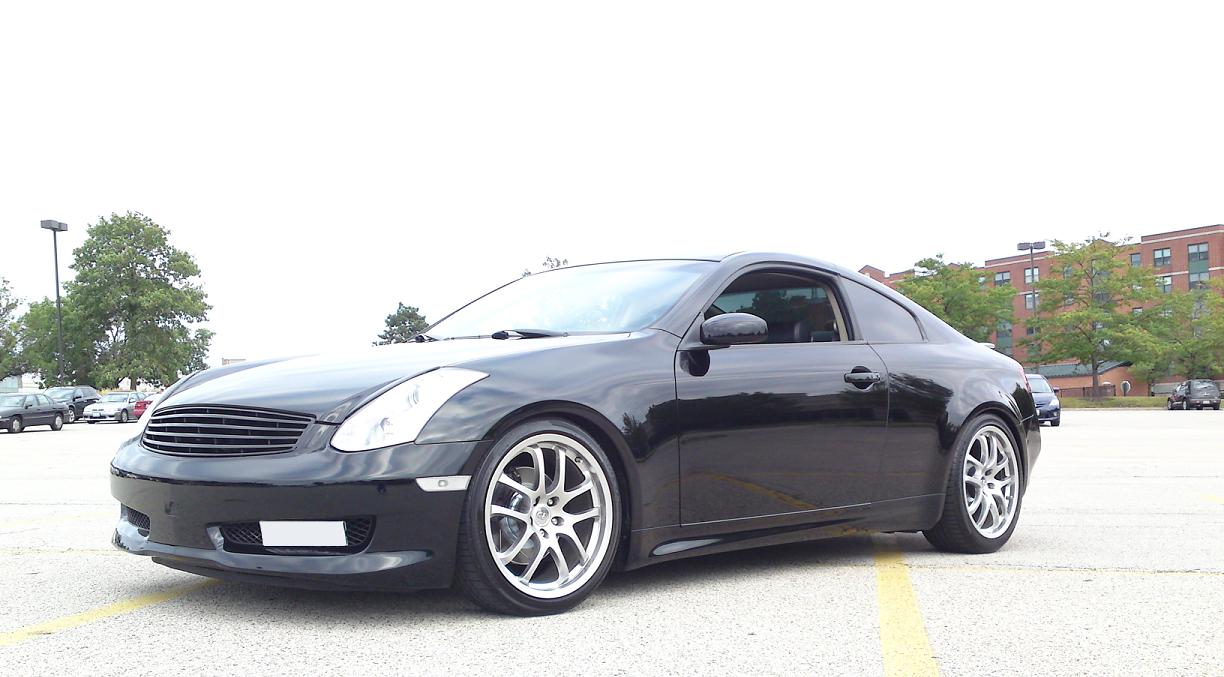

Posts: 626
From: Chicago, IL
Here's mine with Nismo S-Tune suspension and 25mm spacers all around. Its not bad to be honest. Since my car is a daily driver, its not too low or stock height in a sense. I still maneuver around potholes and such. You would have to deal with small bumps on the long run if your going to change your current set up. On mine, its stiffer than stock so you feel more bumps then the usual. Speed bumps is not a problem with this. If you really wanna spend money on some suspension though, I'd suggest some coilovers.
