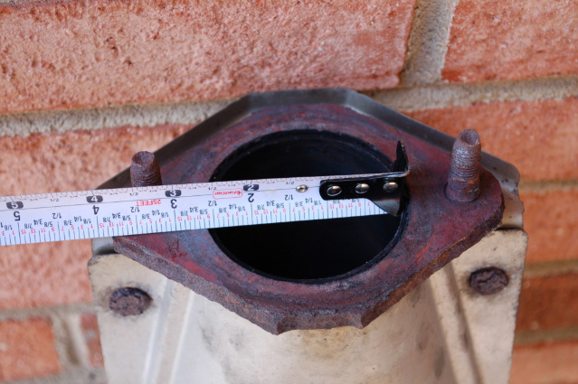

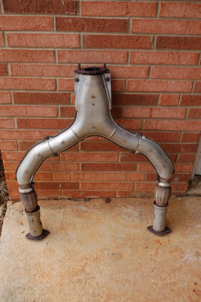

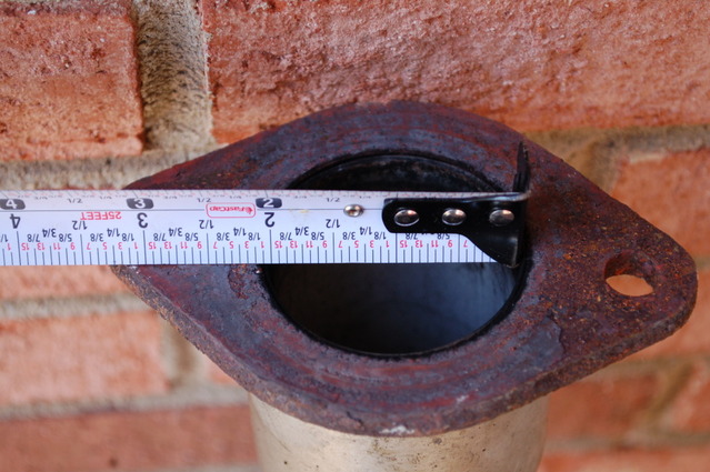

ya i read through that post but heres the pic of the pipe off of the g35x so it looks the same the only question is the inlet and outlets?
Attached Thumbnails hr y pipe-g35xypipe.jpg   hr y pipe-g35ypipeinlet.jpg   hr y pipe-g35ypipeoutlet.jpg
Answer from that thread link above:
https://g35driver.com/forums/4515278-post568.html
Scroll down for the HR dia...
