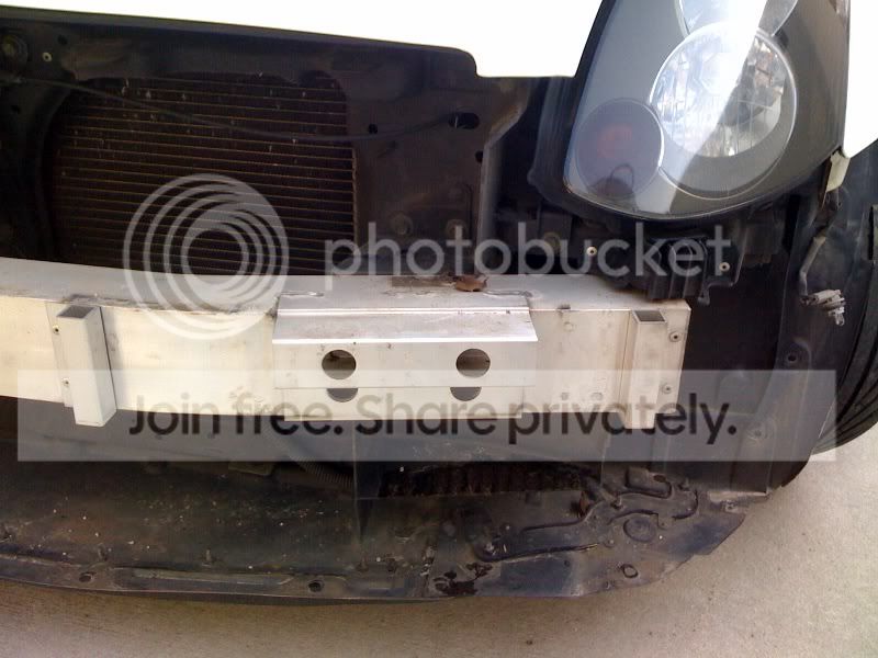

So far I have taken the 12 bolts out of the bumper and the 8 plugs and removed the bumper and then removed the foam on the bumper support.

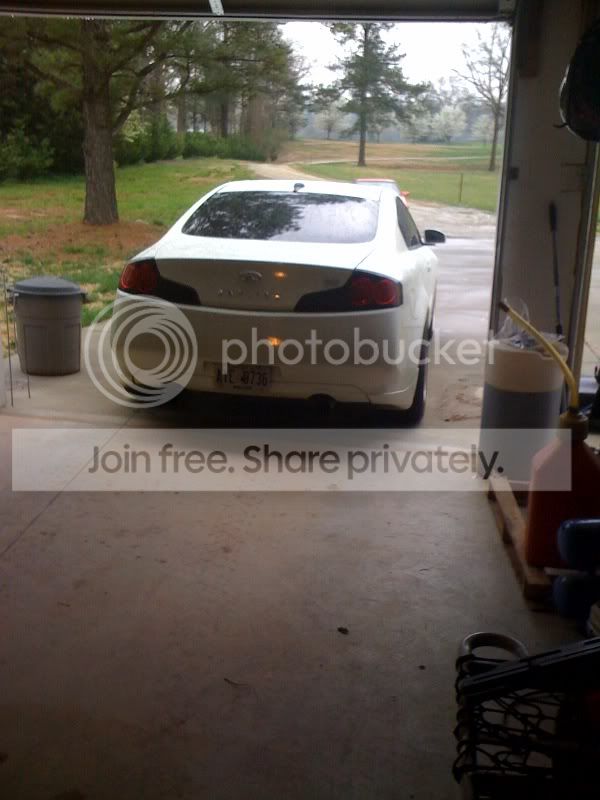

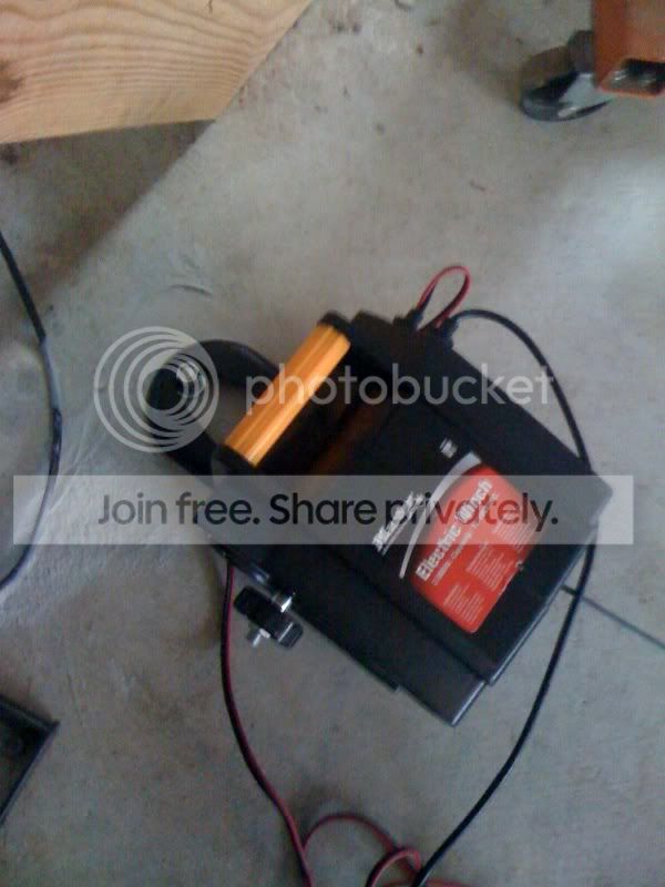

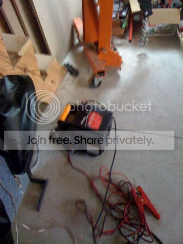

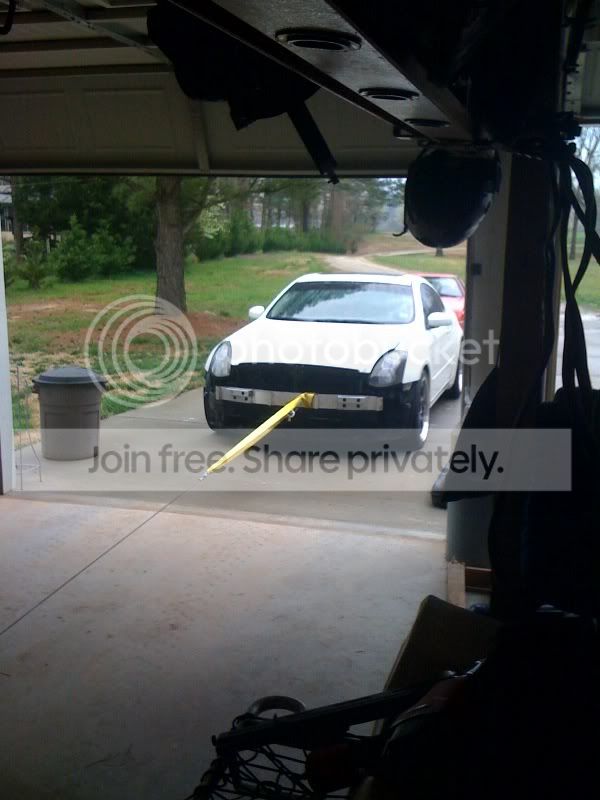

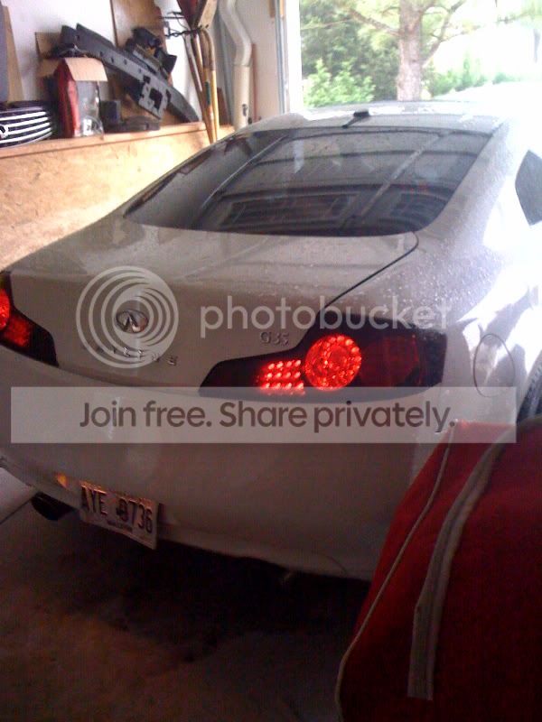

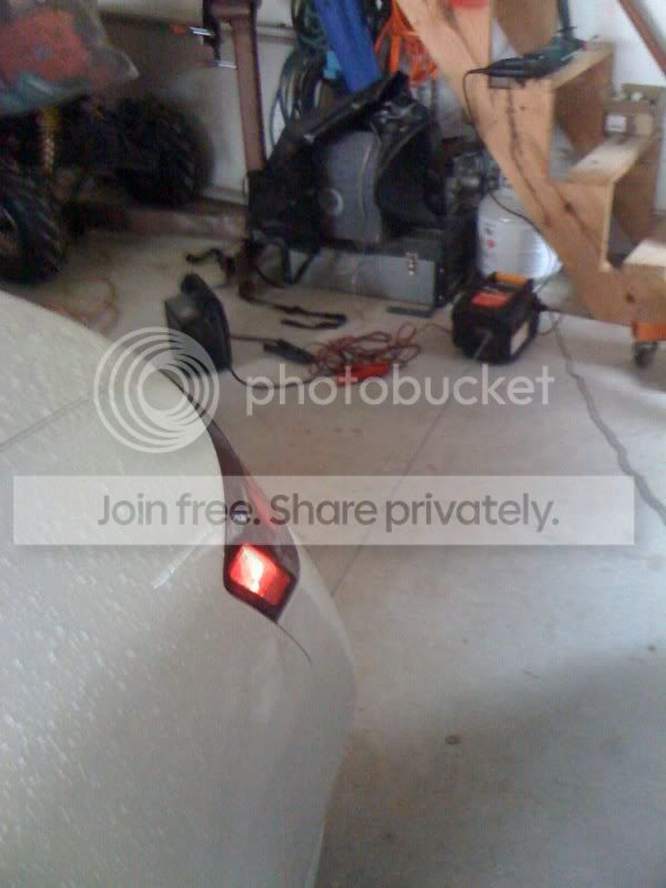

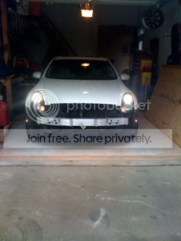

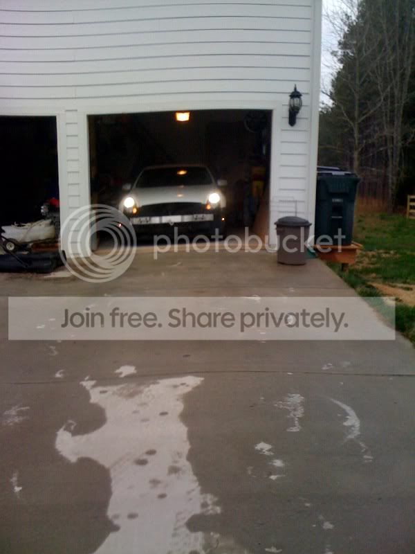

Alright, I finally pulled it into the garage last night with a lot of help from my Dad's 2000 lbs electric hitch wench.
I drilled a hole in the garage floor and set a anchored 5/8" bolt in the floor and hooked it over it.
I pulled the car towards the garage, then turned the wheel and rolled it back and turned the opposite and rolled it forward down the hill. Then backed the car in.

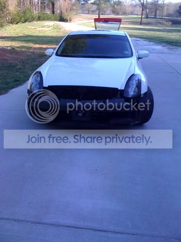

after spining around in the driveway

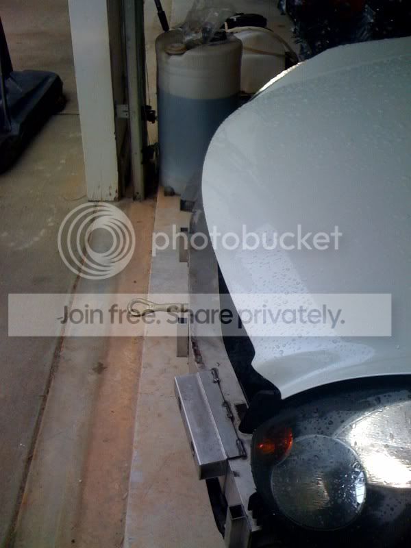

Here is the little winch I used to pull her up and in
Funny thing was, when I got it mostly in the garage, the auto lights came on as to say "I'm still alive"
The garage lip was rough for the little winch to get the car up, but we made it

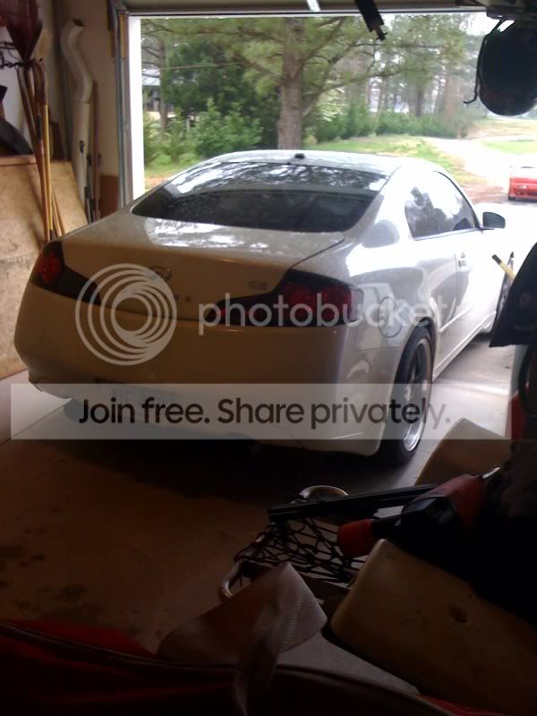

Just barely inside the garage so I have plenty of room around the other sides of the car

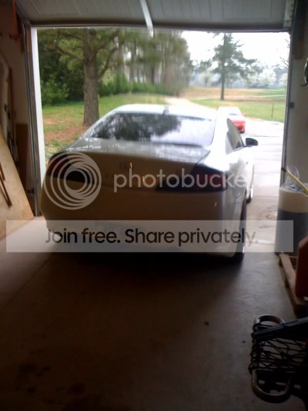

The car is in it's resting spot
Old Motors final resting place before dismantling
Sittin' in the da Garage

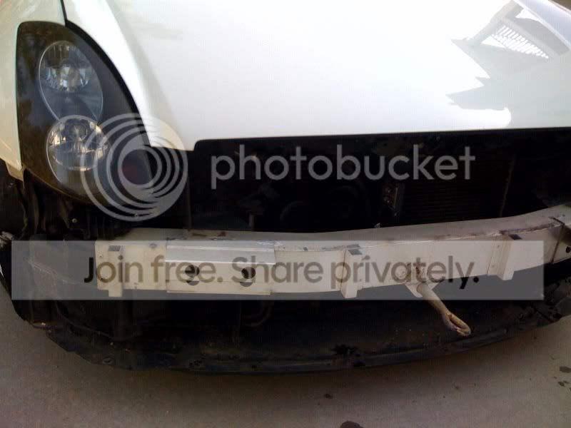

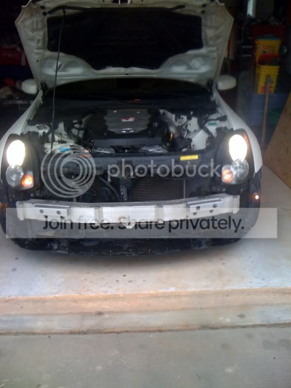

After removing the aluminum bumper I discover this in the front left plastic, wedged under a metal support
The radiator was FULL of leaves, bird feathers and trash

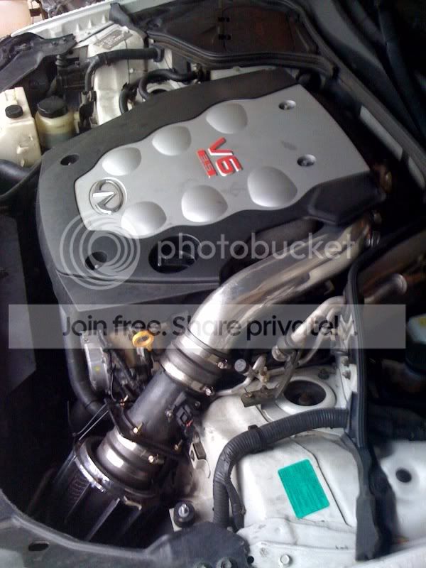

After removing my CAI I found why my A/C stopped working. Looks like the CAI rubbed a hole in the return line of the A/C system. Gonna have to get that fixed now.

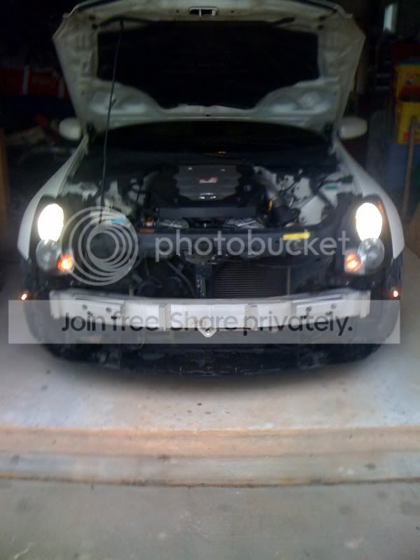

Got the front off

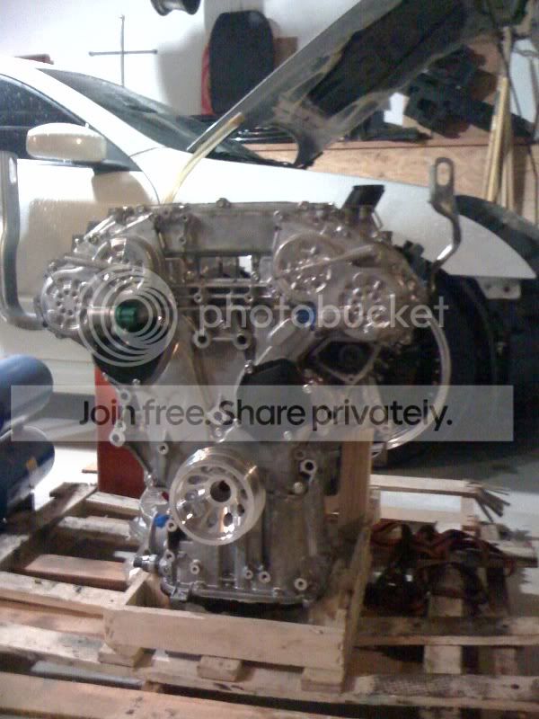

Starting to add parts to the new block....
Motors gettign closer to removing. Have to take loose the tranny.
Yanked it out.... Came out surprisingly easy
I found while removing the coil packs that I had a valve cover leak in the #6 cylinder
these, I think, are the Cam position sensors.
After removing the intake I found these little Japanese labels just sitting in the belly of the block
Motor is coming along nicely
Stripping a little at a time from the old block and putting it on the new
The guy that I bought the new motor from also sent me a new oil filter for it. That was nice
The wiring is a intimidating mess, but surprisingly not all that complicated.
Gonna need a clutch after while. Prolly another year or so. I'm really easy on my clutches.
Mounted the flywheel and clutch up

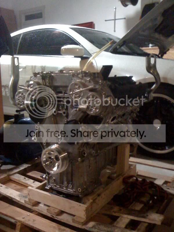

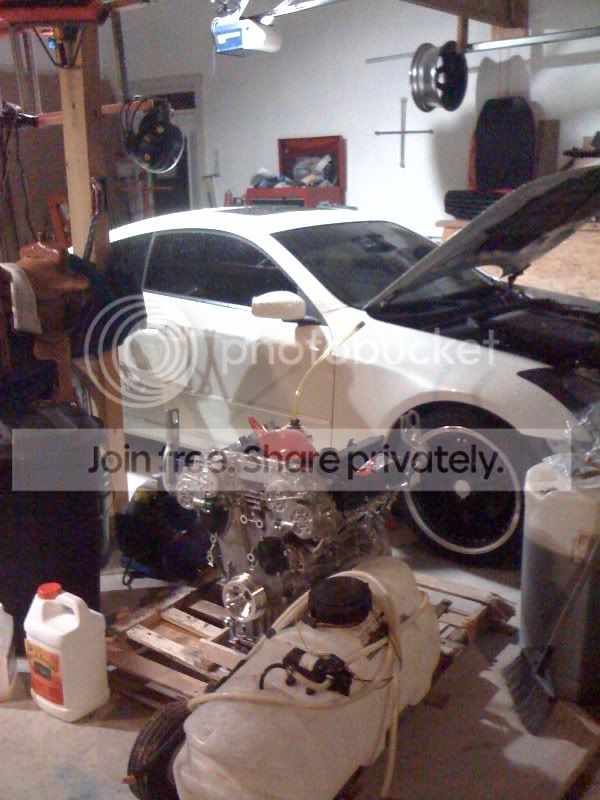

New motor and trans is ready to go back in
It was really helpful that my new motor came with the factory hoist bars that bolt to the block. Otherwise it would have been hard to find a place to lift it
Old motor getting ready for Ebayin'

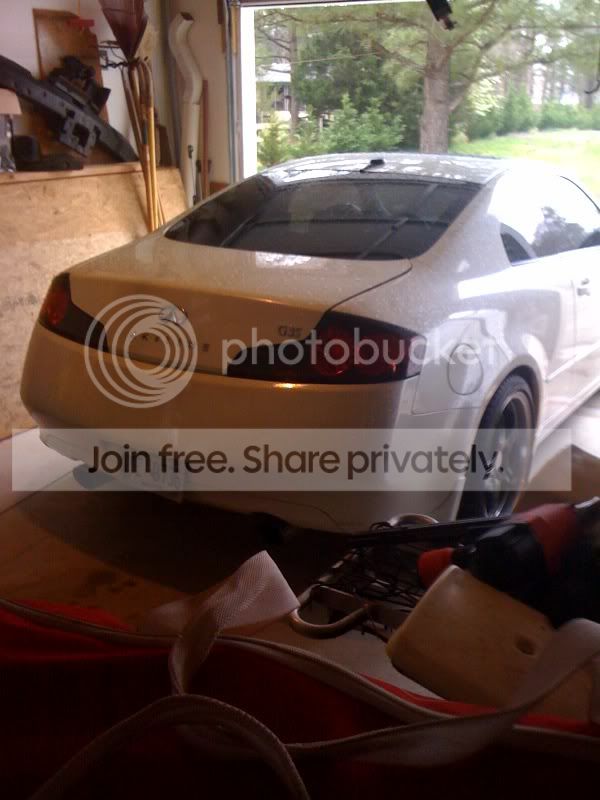

After re-installing the motor I took a lot less pics. Here are the few I have

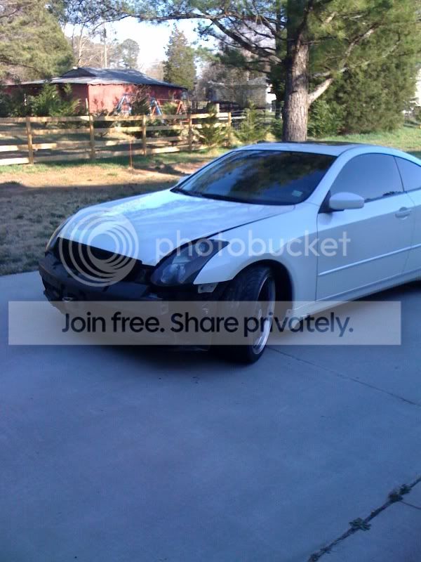

By 9:30pm last night I had it running, and pulled it out of the garage.
I started at 11am on Saturday worked till about 7:30pm, went to Church Sunday Morning, came home and started at about 1:30pm and worked again till 6pm, then Monday from about 2:30pm to 9:30 pm and finished it up.
I went to drive to work today, even without a front bumper, but that didn't work. The plastic fairing on the bottom that connects to the bumper flapped too much so i will have to wait for the bumper so I don't hurt anything.
BUT it runs great.
