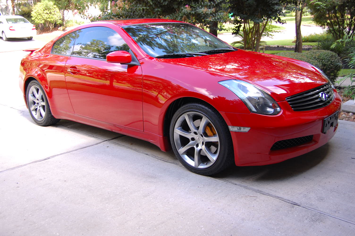

I recently purchased an 04' red 6MT with 23,000 miles in very nice condition but I have noticed the VDC engaging much earlier than needed. Has anyone experienced this problem?
