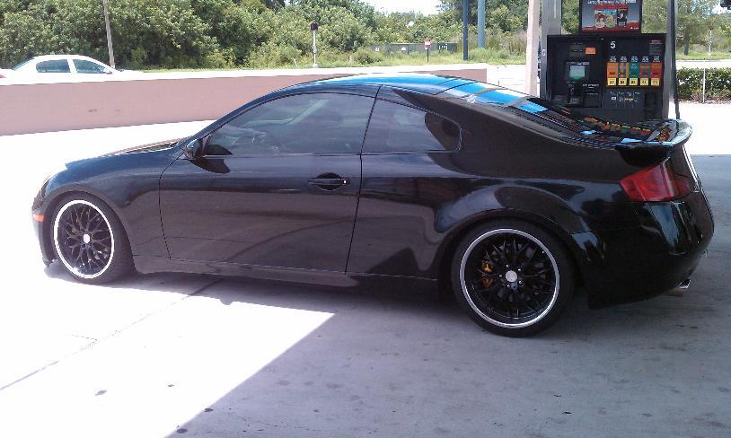

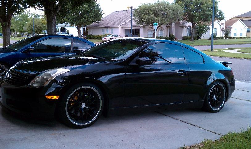

I have the prokit installed on my car for about a year now and it dropped the rear and front significantly and gave me a pretty good stance ...
Attached Thumbnails Suspension Question?-car-driveway.jpg   Suspension Question?-car-gas-station.jpg
