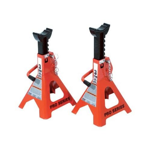

The Question I got is with Jack Stands some of them come Y shaped at the top others are U shaped and other are flat..ect
The jack stands I am looking at
How do I get these to hold up my car with out ruining the skirt and on the jack spot, I seen some people use an adapter to fit 100% with that little lip that sticks out. But if you dont use the adapter how do you put it on the jack? Preferable does someone have a pic?
+1 these are what i use
Rotate your jack stand 90 degree so it U-shape is running parallel to the car. I wouldn't put that over the pinch weld point, but long the inside of the pinch weld point. There should be a little bump about 1" long right next to it. The head of the jack stand should span across that bump.
Old Sep 2, 2010 | 03:32 PM
thescreensavers's Avatar
Mr.202?
Posts: 9,751
Likes: 206
From: WPB
So this little flat area next to were you put the stock jack? Also if I were to use my jack itself, that little hump next to the flat area is were I would put it?
