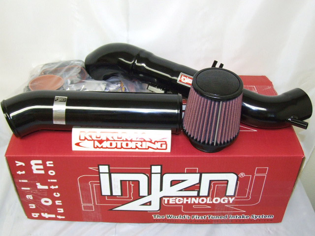

So im on ebay buying a INJEN CAI
wtf is the difference?
one just have a weird pipe shape and the other one just has long pipes, but they still both say CAI

I think but don't quote me on this and I'm pretty sure some of the other guys can chime in on this. One is a short ram tube that is the same size as oem and the under is the longer version that actually dips Down near the bottom of the bumper. Again just what I think and I'm pretty sure I can be corrected if I'm wrong.

The top pipe is the "Short Ram" pipe. You can install this when its "rainy season" to help prevent getting water in your intake, you don't have to take the front bumper off to install it, and it looks awesome and sounds great.
The bottom pipe is the "CAI" pipe. Basically just an extention added to the Short ram and it moves the filter lower and right behind the front bumper. This will need the front bumper to be removed for install, and during good rains you will risk getting water in your intake.
This is a great setup because you can choose either one depending on the season, it looks great, and it sounds awesome. The short ram takes 15 min to install. (Just make sure to remove engine cover, even though directions do not include that step) The CAI takes a little while longer cause you have to remove the front bumper.
I live in Florida and it gets pretty hot here, and I did not personally feel a loss in HP from the CAI. I hear a lot of people talking about "heat soak" but I didn't really feel a difference.

I just have it on as a "short-ram" because its "rainy season" here in florida. I will put the extention on in a couple months when it stops raining.

You only remove the bumper for the cai extensions, not the short ram.
