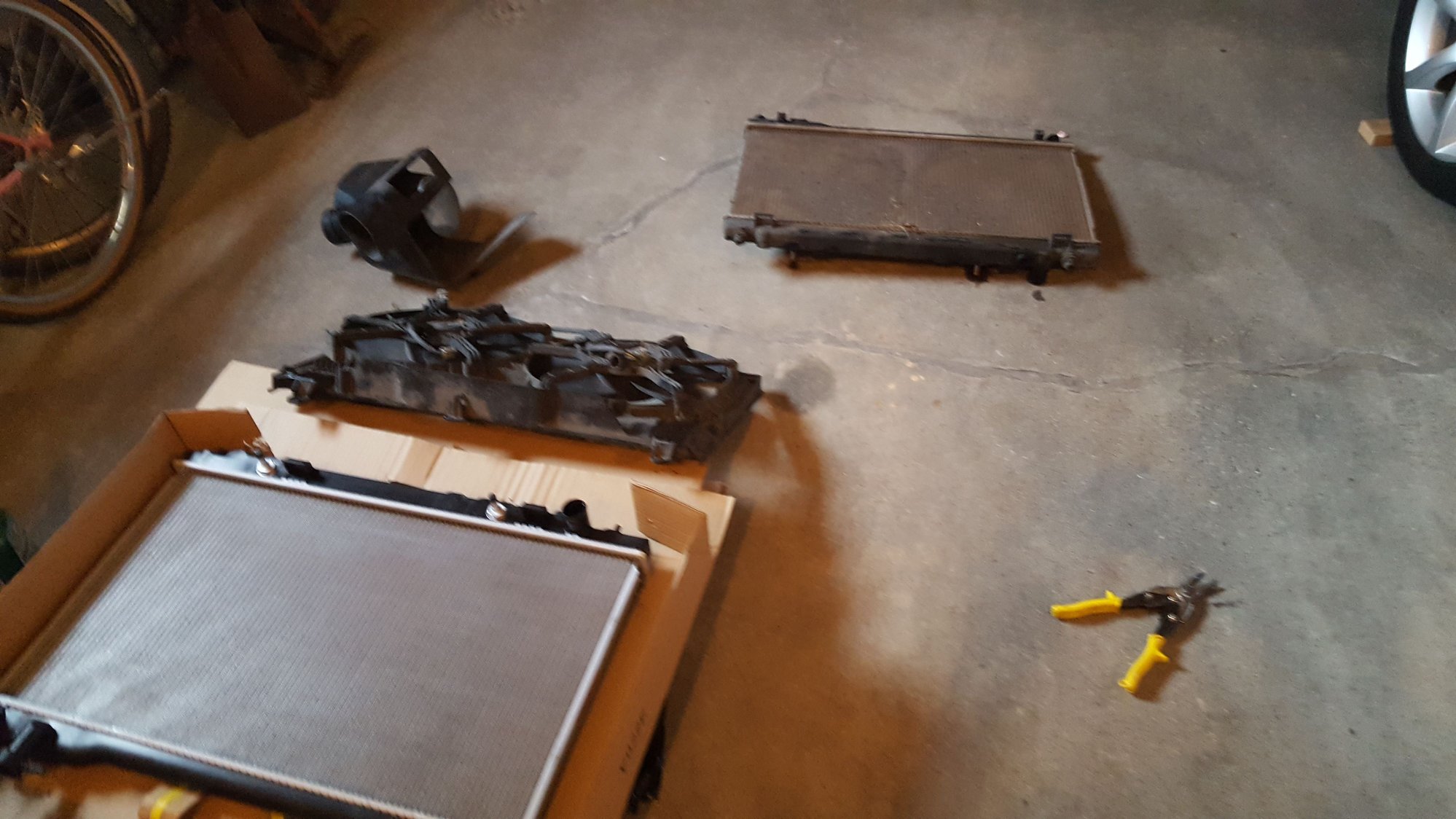

Posts: 26
I have coolant all over my radiator and leaking onto the ground and the bottom of the engine compartment of course. I just bought a new radiator already without checking the hoses. The Temp gauge was fine when I drove it, only drove the car once since I bought it. The radiator cap had crystallized goo around the top much like an old bottle of any condiment in the refrigerator dont know if that means anything.I'm assuming it was the radiator and not just a hose. Bought a new thermostat as well.

I just finished removing my old radiator... I've only driven the car twice and have another vehicle so thankfully time is not a factor for doing work on my car. I thought it was a just going to be a clamp and I bought a radiator for nothing but after examing the old one it was toast. It was extremely dirty and had a pile of debris 2 inches high accumulating from the bottom blocking air flow. so far I've invested 180$ cdn for a thermostat and radiator so about 140 american funds. It has been a very cost effective endeavour and I plan on doing all the Infiniti maintenance myself now before I put the new rad back in as there is more access to everything right now.
here is a pic of the old rad beside the new one. no wonder it was overflowing.

Thanks man. Yeah that old radiator looks rough! Your car will thank you for that one! I had leaves and pine needles clogged up on the inbetween the AC core and the radiator, im sure it was choking on all that junk caught inbetween. No wonder it failed with summer temps nearing 100+ degrees
