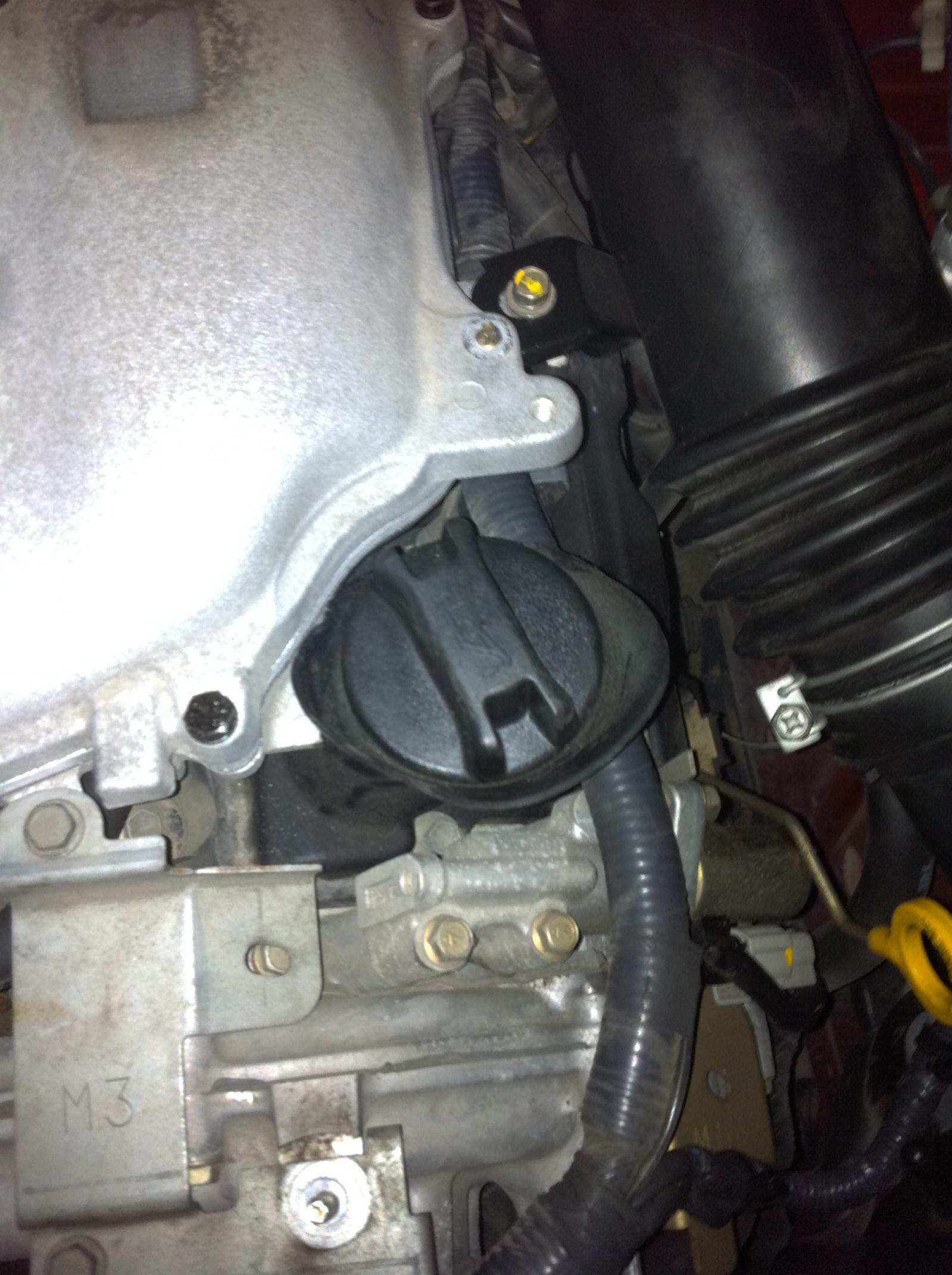

air leak? check clamps on intake tube. Not really sure what else it could be i've never heard of this.

Thanks fastgkid. We fixed the problem. The rubber piece under the oil cap was trapped inbetween the gasket and the cover. So you were correct! air leak! Heres a pic for people if they stumble upon the same problem
Notice: Pic is after problem was fixed. Rubber piece is tucked under to simulate what it looks like.

When I added my MREV2 and spacer, I removed the rubber gasket around the oil filler tube completely.
