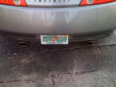

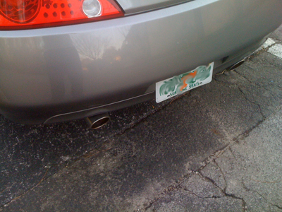

anyways pics
maybe its just me/the angle/my head
when you look at it from the right, it looks fine, but from the angles posted above, looks like the left is sticking out more

Mine is the same way.. I gotta replace my midpipe because it is bent at the curve near where it bolts to the exhaust..

Try loosening the bolts on your exhaust, move it around on the hangers and then re-tighten. Might try to get a friend to help so you can pre-load the exhaust to fit right and tighten as it is held in position.

Did u back into something?? The tip looks bent..

Yea I'll have to check it out later on this week and get under the car to see whats up.
No...?
Are you talking about the right tip? It does look a bit bent but in real life it isn't. Its just the picture I guess.

I wouldn't even worry about it. I was expecting it to be a lot worse... but from looking at the pictures you posted, it's barely even noticeable. The time spent to fix this would be better spent on doing maintenance items or mod/upgrades in my opinion.

Yeah I know, you're right. I was seeing if this is "common" and other people had this.
