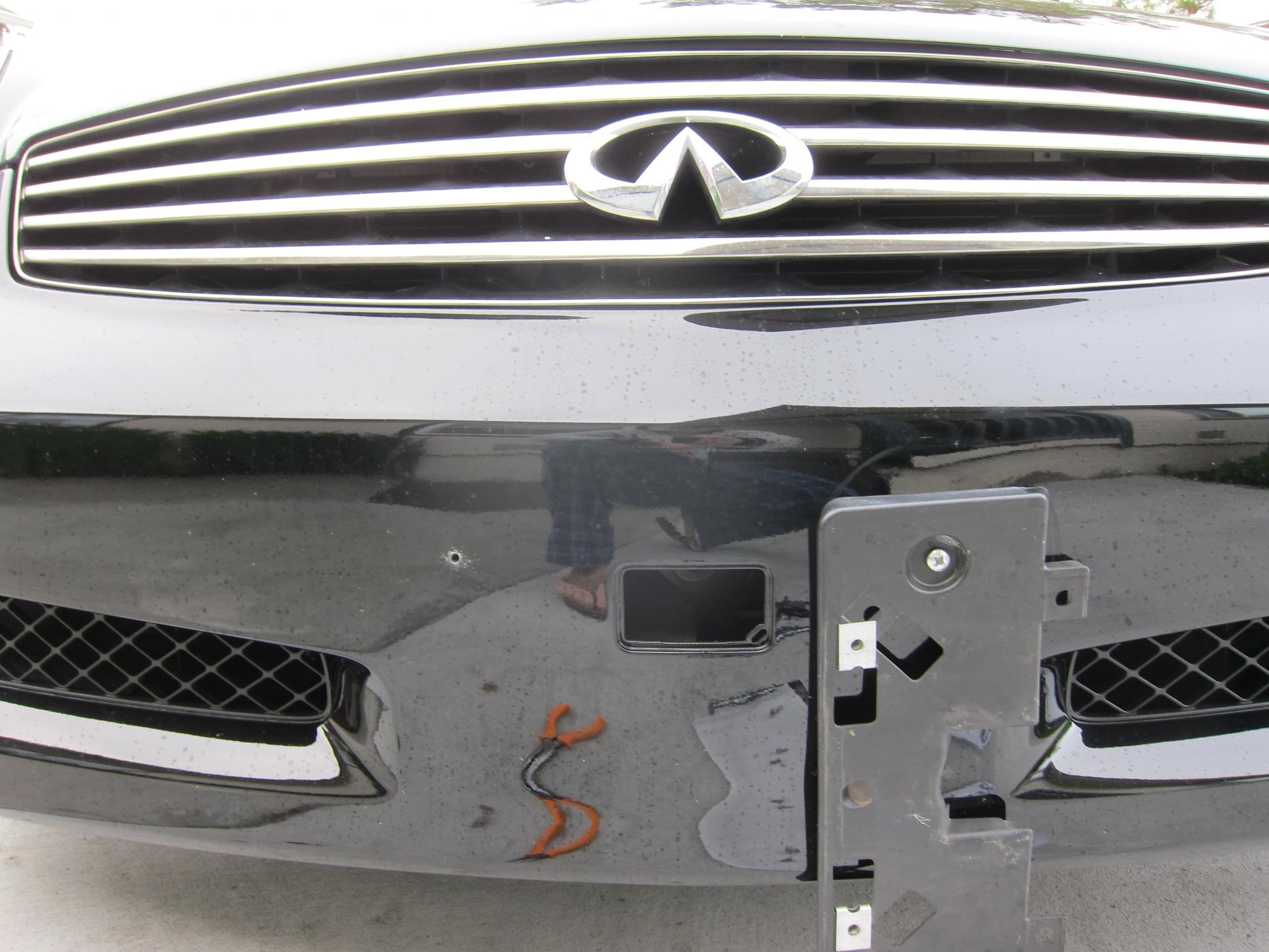

Hi Guys,
I just took off the front of the license plate and...
Any remedies for this? Seems like maybe the dealership can order this part for me?
I've seen this whole covered by many others G's as well, so I don't think it's just mine.
-Maxam

get the bumper plug/tow hitch cover (same thing)
You can get it from dealer or something.
easy fix.

its a tow hook hole.. you can buy a cover... you can order the part from infiniti. its not a big deal.

My Two hook cover was actually in my leather goodies in the trunk...as well as the Key hole cover and the optional parts to delete the center armrest. Did you look? it was a suprise to me...

Honestly would be more concerned with filling the holes where the plate was mounted than the tow hook.

^ Yeah I hated when I moved from NC to Va I had to get one, except I just ride around with it in the cabin. Ill get a hide-away or zip ties once I get a tix. Anyway OP check the marketplace because the dealership is way overpriced.. Also there is a DIY on here for covering up those holes. Gl.

Quick! Put your license plate back on!
Seriously, the tow hook cover and a couple of plastic push in caps (like you get at Autozone in those little "help" packages) should get you going.

You can buy a tow hook cover from our Infiniti sponsor Rick @ 800-919-8130. Try HomeDepot or Lowes for plastic plugs for the bolt holes, paint them with touch up paint....it won't be perfect but damn close!

Nylon Plugs, and tow hook cover.
If you buy the tow hook cover at the infiniti or nissan its gonna come UNPAINTED.
better to get it from the nissan its cheaper prolly.
When you go get your tow hook cover painted i suggest to paint the nylon plugs as well to match your car
