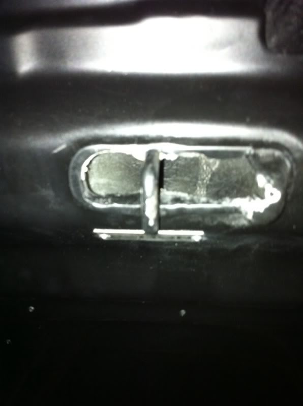

alright i took some pics so u guys can see
this is how my hood sits on the latch i can push it down but the claw won catch it
and this i what i had dremeled to clear and the other side is what i believe is the safety which tore right off when gently closing the hood

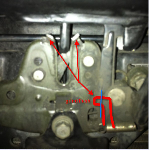

From: Chicagoland
When I installed my Seibon hood, I had to grind down the some of the material around the latch. Hood was hitting the two points that curve out. I can take a picture when I get home, if it helps.
Old Feb 10, 2011 | 01:31 PM
  #29
jwolfpk's Avatar
Joined: Jun 2003
Posts: 959
From: Hawthorne, NJ
if you could take a picture that would be a great help..so basically all you did was grind those pieces down and the hood closed??did u raise the latch up?

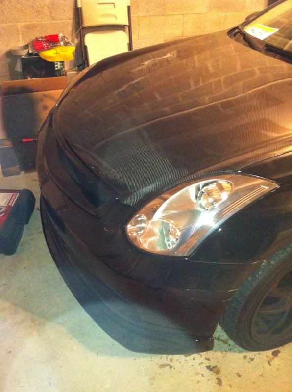

Success!!! it was basically a combination of what everyone said lol heres a ****ty pic from my iphone
