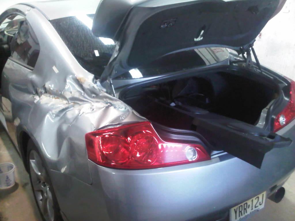

Tail light is cracked on the inside where the quarter panel is pushed in. I ended up buying a recycled deck lid with spoiler but it showed up today with an aftermarket knock-off spoiler on it and a broken brake light. Just shelled out an extra $100 for a different one.
Anyway, repair is under way... I gutted the entire interior and right now I'm trying to see if I can get the quarter panel off as a whole without having to drop the headliner. If not, we'll cut above the quarter glass.

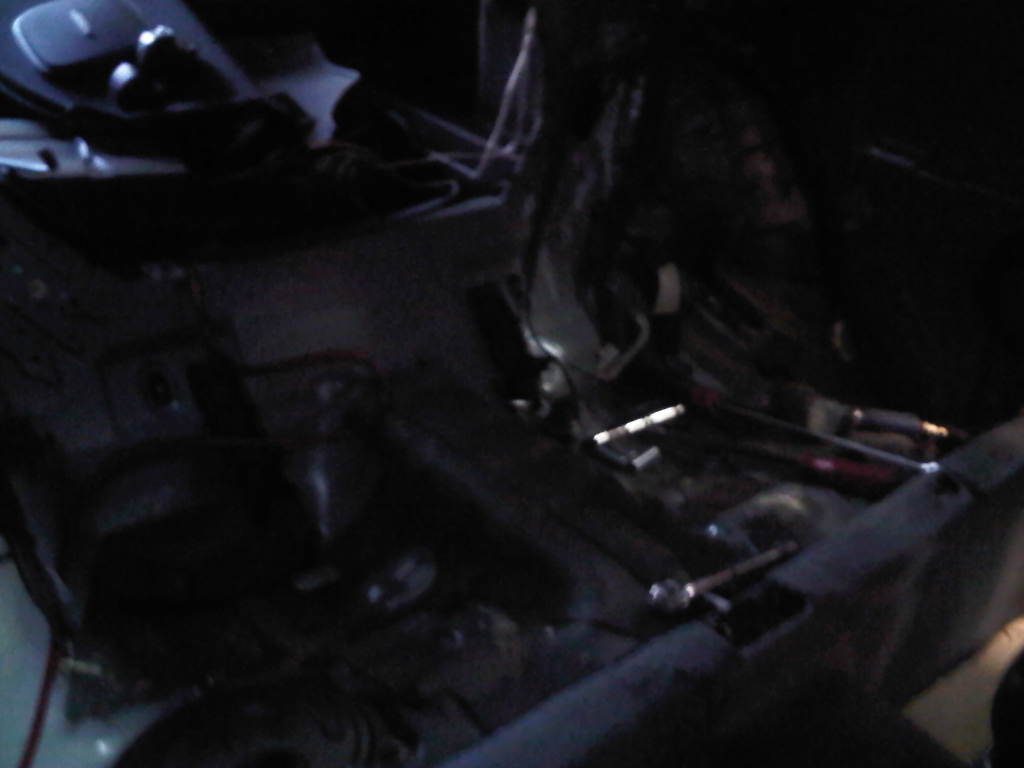

Decided to split the welds at the edge of the panel so the final product is super clean with no plastic! Just gonna be a little tricky because the quarter edge is under the roof panel.

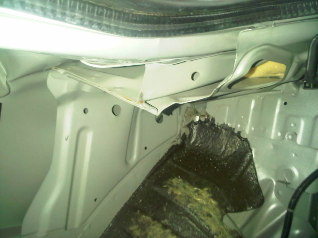

Here you can see the damage to the inner quarter inside the trunk... doesn't look too bad, we'll see what lies under the exterior quarter on Monday morning.

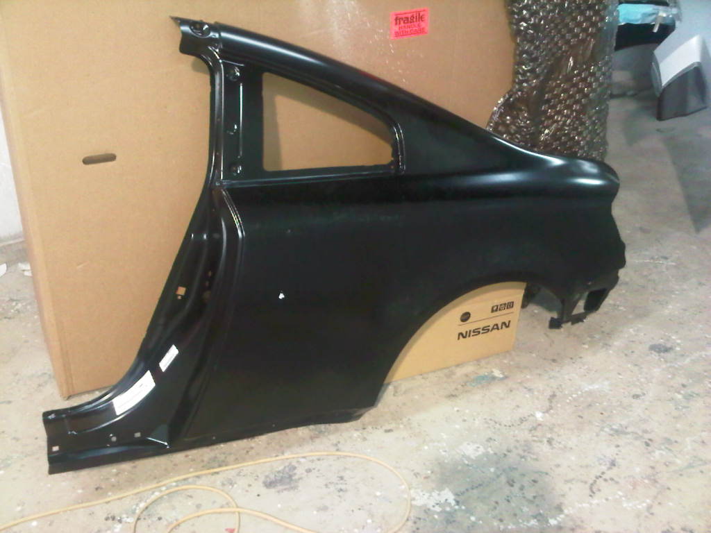

My brandddd new car! Well, part of it..
