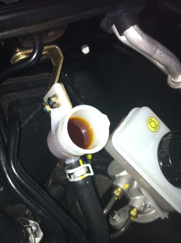

Old Jun 30, 2011 | 07:22 PM
MurByrne's Avatar
Joined: Mar 2011
Posts: 65
Houston, we have a problem?
Old Jun 30, 2011 | 07:27 PM
irishsig's Avatar
Posts: 2,288
Likes: 51
LOL, yeah it shouldn't look like 30 year old scotch.
Old Jun 30, 2011 | 07:28 PM
MurByrne's Avatar
Joined: Mar 2011
Posts: 65
Well dang, I'm going to change it tomorrow and i'll let y'all know how it goes. My first work on the G, I feel like a real owner now
Thanks again irishsig, i'll update you on how it turns out

changed the clutch fluid today. Feeling MUCH better

Nice! Mine looks very similar to that, not as dark but probably close.
Gonna change mine out this weekend.
