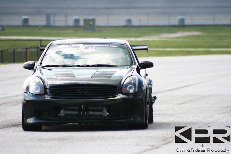

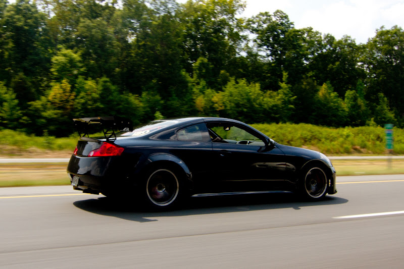

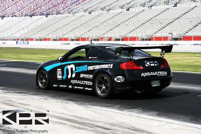

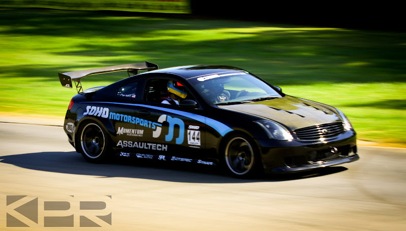

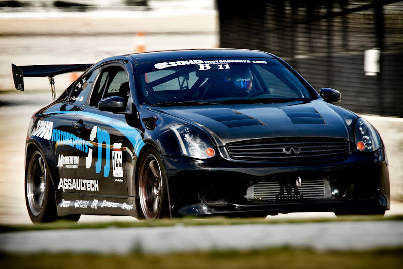

SOHO Motorsports is a high end tuning shop based in Charlotte, NC specializing in the modification and tuning of sport compact vehicles with a niche in Infiniti and Nissan platforms. With years of experience in ever form of motorsport from NASCAR to NHRA, we have used our knowledge of what it takes to be successful on the racetrack and have translated that into every vehicle we build. Whether it is a simple install or a full race build, we hold our vehicles to a standard that is unmatched by any shop.
After opening in 2009 we chose to use one of our shop cars, Kevin Parlett's 2005 Infiniti G35, as a platform to build a car that would not only represent the SOHO Motorsports ideology of perfection and performance, but also create a car that can compere in any Time Attack series and win anywhere. We knew we would have to create a monster to get the car we imagined in our heads. After many long nights, when it was all said and done, we even surprised ourselves.. The end result is a Frankenstein Batmobile thats half Infiniti and half NASCAR.
The Build -

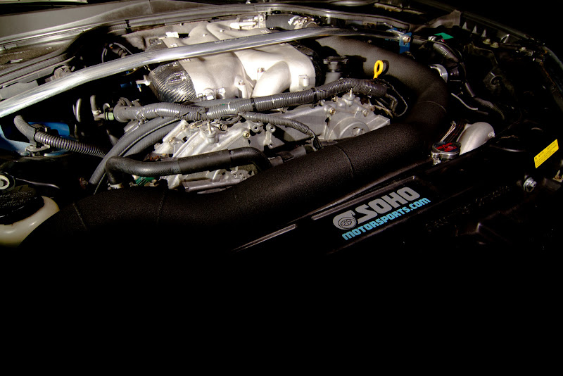

Since we wanted to build the fastest Time Attack G35 on the planet we decided to retain the use of the base platform for the G35 especially the VQ35DE RevUp engine, which would provide the perfect power curve for time attack especially when we added some boost. Along with the fully built VQ we added a Momentum Performance GT35R Turbo kit to add more power and get us up to the 600hp / 600tq we wanted. Keeping all of the power planted we chose KW ClubSport coilovers and SPL suspension components to keep the car balanced at all times.

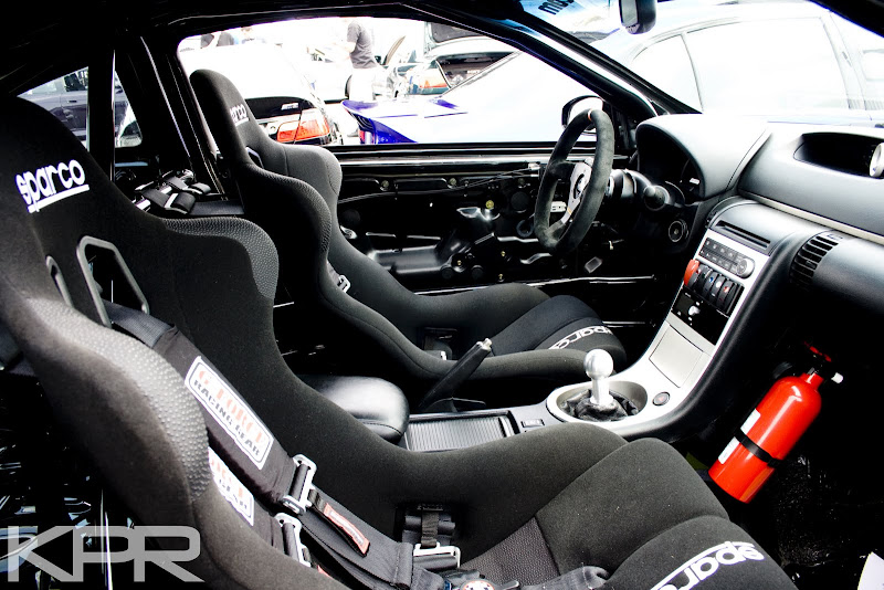

Carbon pressed Volk TE37 SL's wrapped in sticky 315' Toyo R888's keeps the car firmly on the ground, and with the help of a NASCAR kevlar front splitter and APR carbon fiber spoiler traction is never a problem. Not only is the engine, drivetrain and suspension all top quality and race ready, the interior and exterior of the car stripped and showroom quality thanks to custom body, fender and interior work from local NASCAR teams. The final accent in the interior is the Computech DataMaxx digital dash and data acquisition system feeding live data to the driver and crew at all times. The car was built to be the best and it truly fits the bill.

Engine & Drivetrain:
· SOHO Motorsports Shortblock
· Momentum Performance GT35R Turbo Kit
· Garrett GT3582R Turbo w/ Tial Housing
· Tial Wastegate and Blow Off Valve
· JE Pistons 96mm 8.5:1
· Eagle Connecting Rods
· Jim Wolf Technology VQ35 RevUp C8 272 Camshafts
· Cometic .70mm Thick Head Gasket for 96mm Overbore
· ACL Main and Rod Bearings
· ARP Main, Rod and Head Studs
· Nissan Engine Assembly Seal And Gasket Kit
· AAM Oil Pan Spacer Kit
· Block and Head Port/Polish
· UpRev Cipher Engine Management
· HKS EVC VI Electronic Boost Controller
· Deatchworks 800cc Injectors
· Brian Crower VQ Single Spring & Titanium Retainer Kit
· Exedy Twin Carbon Clutch and Flywheel
· Quaife ATB Differential
· Driveshaft Shop Level 5 Axles
· Cosworth Carbon Fiber Intake Manifold
· Cosworth High Volume Fuel Rail Kit
· Seatrab 13 Row Oil Cooler Kit
· Greddy 15mm Light Weight 1000ml Oval Catch Can
· Mishimoto Low Temp Thermostat 62 deg
· ATI Super Damper VQ35
· Koyo V-Core Radiator
· Momentum Performance Solid Motor and Transmission Mounts
· Momentum Performance Headers
· Momentum Performance Turbo Back Single Exhaust
· Samco Radiator Hoses
· Aeromotive Fuel Bypass Regulator and Fuel Pump
· BMRS Custom Fuel Lines
· B&M Short Shifter
· NGK Iridium Plugs
· Agency Power Steel Braided Clutch Lines
· ATI Fuel Cell

Interior & Exterior:
· Computech DataMaxx Digital Dash Data Acquisition System

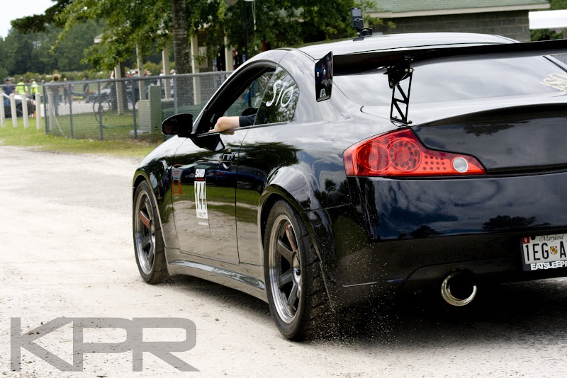

· Volk TE37 SL Wheels 18 x 10.5 +22 F, 18 x 9.5 +15 R
· Toyo R888 Tires 305/35R/18 Rear, 285/35R/18 Front

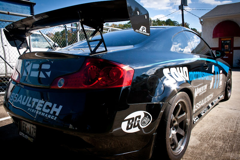

· APR 67” GTC-300 Carbon Fiber Adjustable Rear Spoiler
· Siebon Carbon Fiber Hood
· Strafe Front Bumper, Trunk and Sideskirts
· Bingz Rodz Custom Fenders and Interior

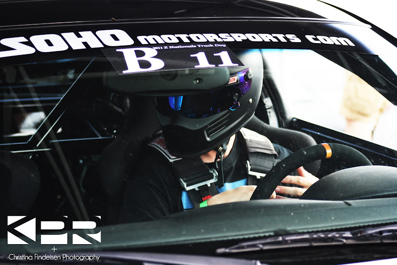

· Tom Pallatin Motorsports Roll Cage
· Sparco Evo Seats
· G Force Camlock Harness
· Momentum Performance Shift ****

Pretty sick! Interior is SWEET!

just noticed the rear flares, nicely done
