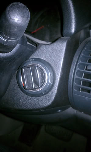

its an 06 so its keyless . so all you do is pushdown and turn but it wont turn! im so mad cant even drive it ive wiggled the steering wheel pumped brakes did everything i can its getting to the point that i want to break it off!!! so fustrated...! Name:  6514425329_599266cfdc.jpg

Out cars have what is called a shift lock solenoid. It is an electromechanical switch that stops the driver from shifting out of park.
Sometimes the shift lock solenoid goes bad and more frequently the control board for the shift lock solenoid goes bad. There is a diagnostic procedure in the service manual that will help you isolate the bad circuit. I was able to do it with a voltmeter. The control board cost me ~$70 (granted this was on a Murano but I am guessing things are similar) and it took 10 minutes to change out.
The good news is you have a shift lock override switch. By your gear selector there will be a little plastic cap. Pry it out and then stick something small down the hole - it will move a lever that disengages the shift lock and you will be able to shift into gear.
Brian

Thanks brian but ive tried the shift lock so many times and the thing won't budge! Idk what else to do but tow it to a dealer .

is the car sensing your key fob? try starting it with the vallet key.

Want to make sure I understand - you popped that plastic cover off and stuck something (like a key) into that hole and pushed down (you should feel some spring tension as you depress) and you still can't shift out of park? You should be able to depress it a 1/4" or so.
When it happened to me I kept trying to push on the cap not knowing it was a cap and it wouldn't budge. Unless your shift mechanism is broken or the linkage to the transmission is jammed, I can't think of a reason why it would be stuck. If either of those conditions were the case, it would probably feel loose and sloppy vs just stuck in park.
