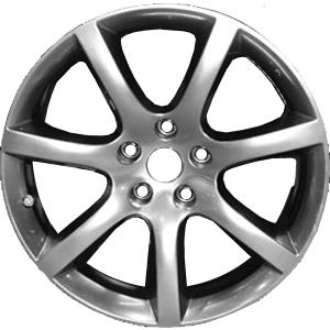

As far as your wheels, I used plastidip on my wheels prior to powder coating them because I wasn't 100% sure I wanted black wheels. Again, take your time with the plastidip and they'll last a hell of a long time. Depending on what wheels your G has (mine has the 19" forged wheels) The plastidip comes out with a powder coated look anyways. Plus no one is going to come up inspecting your wheels close enough to rag on you about using plastidip and not spending $500 to get them powder coated professionally.

- For durability and ease of removal when the time comes, do 3-4 coats. I used roughly a can per wheel and it lasted a long time and came off in one thick piece when I was ready to take it off.
- Your Infiniti cap in the middle, if you have the forged wheels, pops out, just push it from the inside of the wheel.
- Mask of your valve as well just so you don't cake that up with plasti dip.
- Allow plenty of time for it to dry before you place your wheels back on your car, any tackiness will hold onto any little rocks or dirt from the road.
- When you wash your car just normal soap and water that you use on your car will keep your wheels looking clean, I wouldn't recommend wheel cleaner as the solvents will probably dull or ruin the plasti dip.

OP, if I were you I'd go with the powder coating if you're sure you want black rims. It's not as pricey as you think and honestly, you could probably find a friend or a friend of a friend to hook it up or at least give you a good price. IMO $500 is way too much like someone else said. You can find someone who will do a good job for a couple hundred bucks. But like I said, find a friend.

I bought 5 cans, and went through about 4.5 cans for 3 good coats. Bought them at Home Depot was something like $37.
As far as the powder coating goes, eventually, yes, if in the future you love your black wheels go get them powder coated so it's permanent and you won't have to worry about anything. It never happened for me but if something happens to a tire and you need it unmounted or anything that requires a shop to mess with the wheel, it will more than likely get chipped off. One thing, it's very easy to touch up and not notice as long as a huge piece doesn't get pulled off
You may be able to find powder coating done around you cheaper, but the amount of shops near me that powder coat is very limited so I think they just charge what they want. I paid $120/wheel and that was the cheapest. But in the end, I like my stock wheels and I like them black, so I just got my wheels powder coated instead of spending $500+/wheel for what I like.
