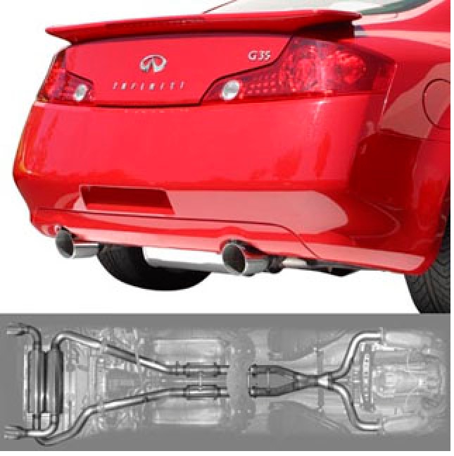

Here is a pic of the Stillen setup and doesn't look like I have any options on swapping out that X-Pipe.

yup, looks like your X pipe is connected to the entire Y pipe, so I think you're stuck. You could try ART pipes, but for some exhausts it gives more rasp, but for some it gives much less, if any. My ARK has almost no rasp now with my ART pipes.. but the berks were terrible. I think Berk are known for causing rasp. You could... just put up with it? lol

There is no way to resolve it without some custom fab work. Because the Y-pipe and the X-pipe are one piece there is no way to replace the Y-pipe. There really are only 2 options, one being to somehow eliminate the x-pipe with straight pipes or cut out the mid-pipe resonators and replace with larger ones. Or just put the OEM cats back on I absolutely loved the sound with OEM cats!
