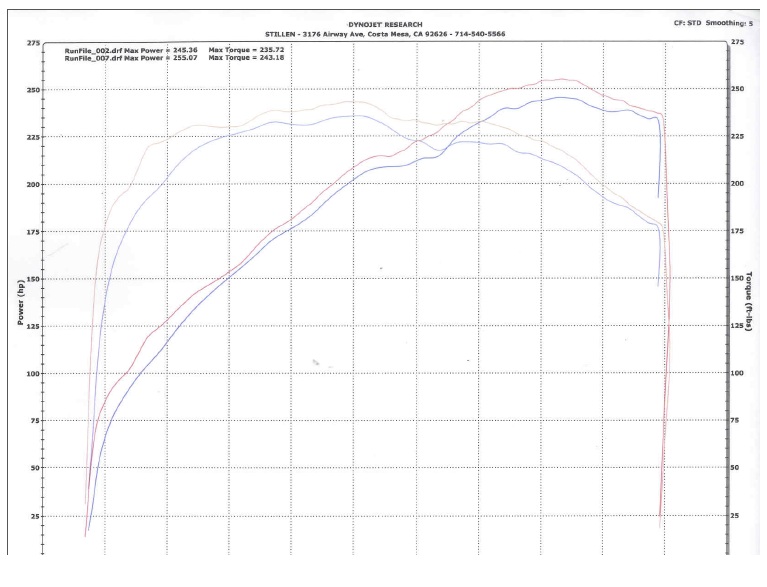

There were 7 runs made on a Dynojet dyno in about 60 degree weather close to sea level. Attached is the dyno sheet of the first run compared to the last run (after the UpRev Osiris tune). My mods were listed in the beginning of the thread.

What type of dyno machine was it? nvm see it in attachment...my posting earlier was in reference to a mustang dyno

It was a Dynojet @ Stillen in Costa Mesa, CA.

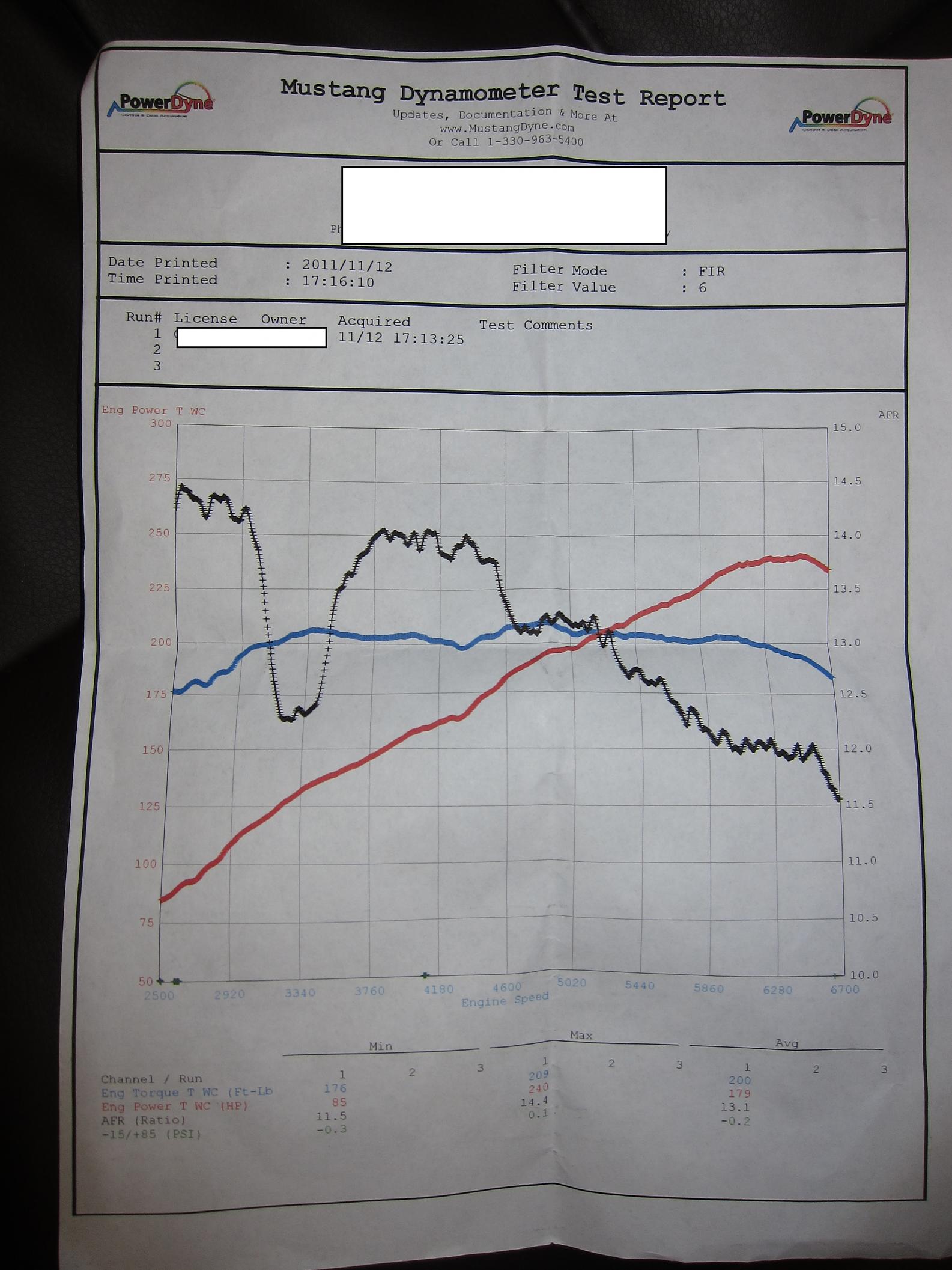

Here is my bone stock sedan rev-up that was run on a mustang dyno with 87 octane. The mrev add 25 tq and 15 hp and I wonder WTF your tune did. I think you haz shi**y tune
MREV
Am I reading it wrong or did you gain 1hp? Sorry, on my phone.

Unforchantly I don’t have the baseline numbers. Just before and after the UpRev Osiris tune which gave me about 10whp as shown on the dyno sheet.
