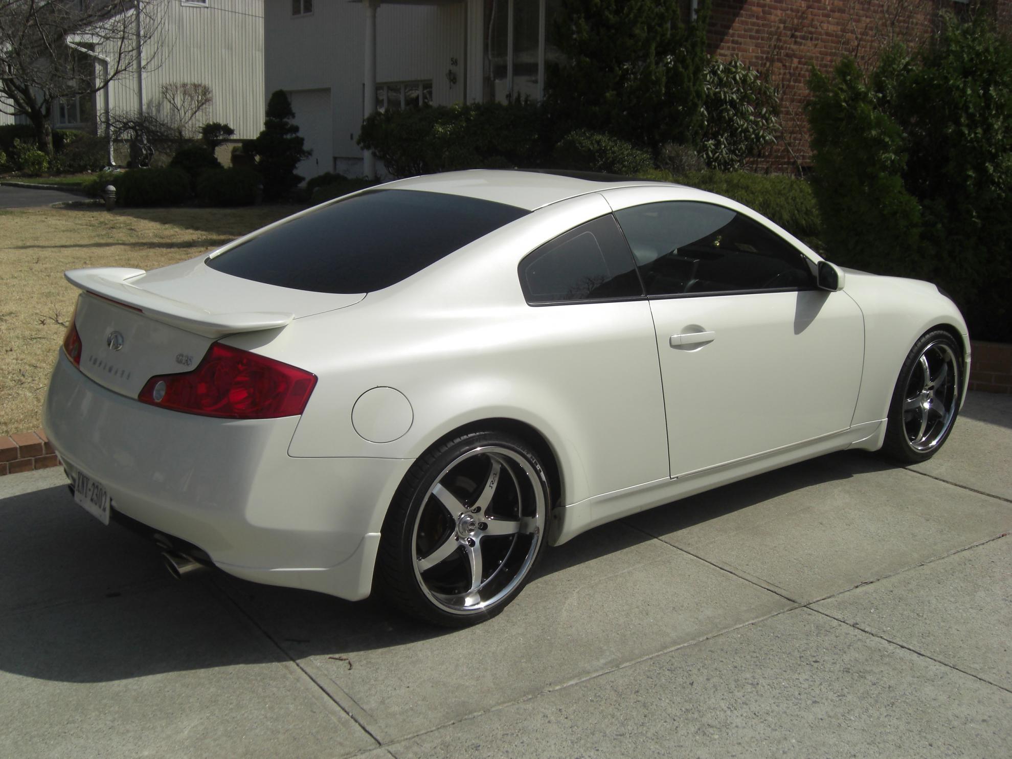

I definitely felt a difference going from 18s to 20s, but I will take the mild loss of power and harsher ride for the looks. I get much more looks and compliments with my 20s. I think it makes my G much more unique. I live in downtown DC so performance only really matters when I hit the highways. Its really up to you. I rather have my car look good when I am stuck in traffic.
Here is an attached pic of how 20s look without a drop. I do want to drop it slightly eventually.
