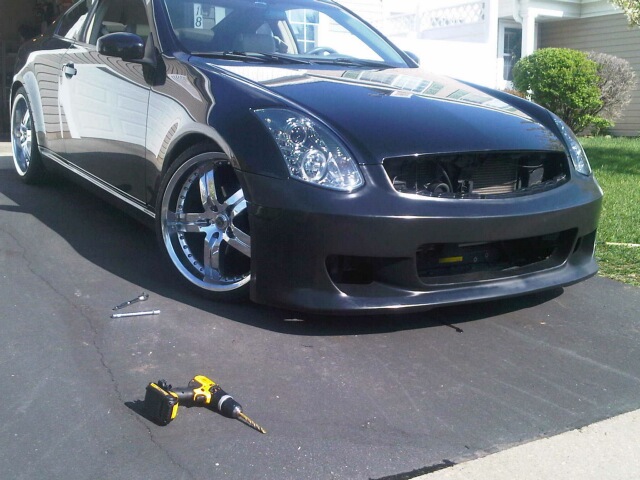

I just fitted up my poly karuma bumper today and like stated above these do not come pre- drilled and some need a little tweaking. Mine also needed some tweaking and not all the drill marks were clearly marked. However if you just take your time and try to put it on and mark where the holes need to be drilled you shouldnt have a problem.
This is relatively easy. I just just use nail polish to mark the holes and they all were perfect. 2 hours of fitment and its dropped off for paint. Any body person who has aftermarket body parts experience should not have any issues what so ever. Keep in mind if it was FG it would take 3 or 4 times longer to fit up
Heres a pic.. These are my winter storage wheels (work GS4's on going on) so dont kill me too much. I know they are hideous

^ Looks super clean man! Nice job on the install.
