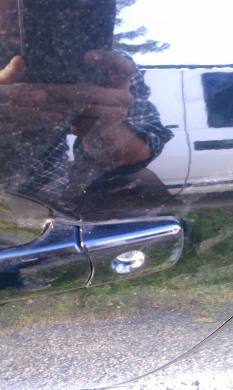

Hey guys I was going to unlock my car with my key since the actuator has gone bad and noticed the whole assembly pops out just like in the pic I posted. I can slide it back to normal like in the other pic, but everytime I use my key to unlock I have to hold the assembly with one hand while I unlock so I don't pull it out. Anyone know how to fix this. I haven't found anything on this. Please help me...thanks!!

The fix for this is simple. Open the door and you'll find a black plastic plug on the door right above and to the left of the lock mechanism in the door jam. Remove the plug and it'll reveal a big hole. Look in the hole and you'll see a screw with a star/hex head. Tighten it up and problem solved.

I had the same problem and this is what I ended up doing. Instead of screwing the screw by screwing straight, you have to angle the screw to screw from the right, while pushing in the key hole really hard. Eventually the screw will catch the thread and screw in. Let me know if this makes sense.
