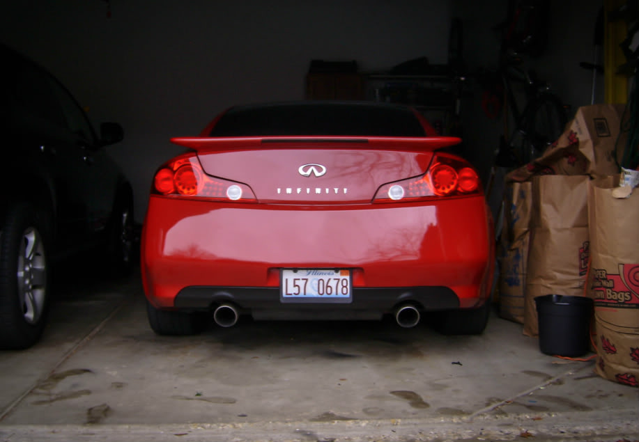

Damn, that car got hit right above the crash bar which made the trunk half the size smaller lol, mine took most of the hit in the crash bar and skid into the bumper and trunk. To get this back to its shape will take some time cause in your case everything has to be pulled back and the tailight seats have to be re-formed so they fit again. In my opinion it will be 3k to repair easily. If you find used taillights, and a rear bumper for $130 on craigslist + repaint costs (unless you find one with same color you are golden)
If you lived near me i would be more than happy to help you out on taking it apart, but trunk, rear bumper, taillights (your tails should just pull out haha) they are very easily to take out just take everything out of the trunk, on the left and right side in the corners you will see 2 bolts those will let the bumper go off, trunk comes off t the hinge's easily. Good luck on this man.
Also was this bought from insurance?
Here is a pic of what it looks like now

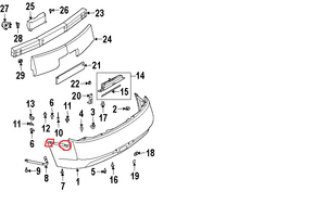

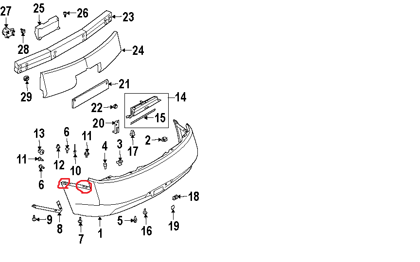

Here is a diagram, look at the red circled parts and the 2 bolts have to be taken out from the inside of the trunk on each corner and the one closest to the wheel with a screw driver from the outside very easy.

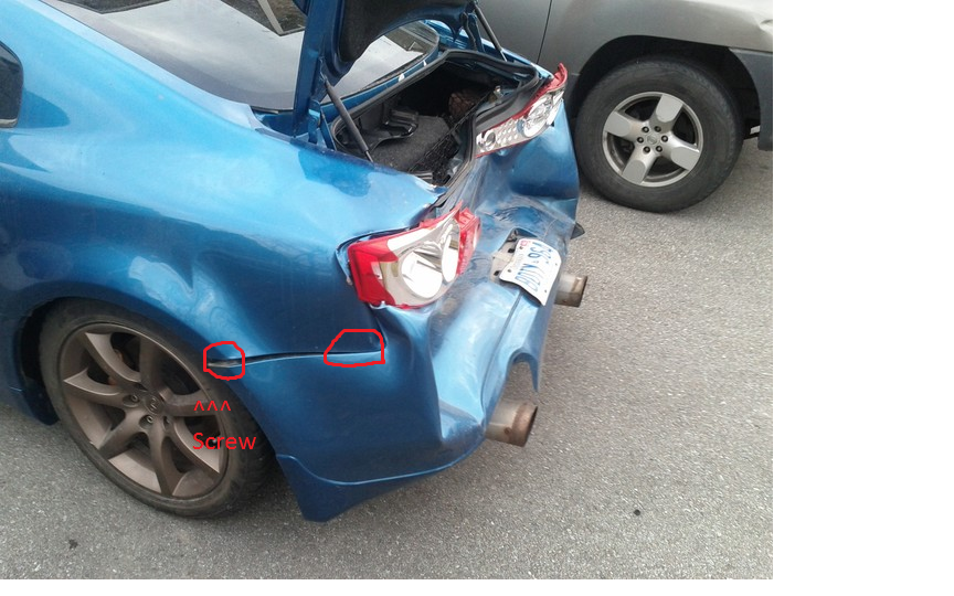

The screw closest to the wheel seems like its already out because the end of the bumper is popped out

Take the carpets off on the side of the trunk you should be able to spot the screws easily, also literally take everything out of the trunk
