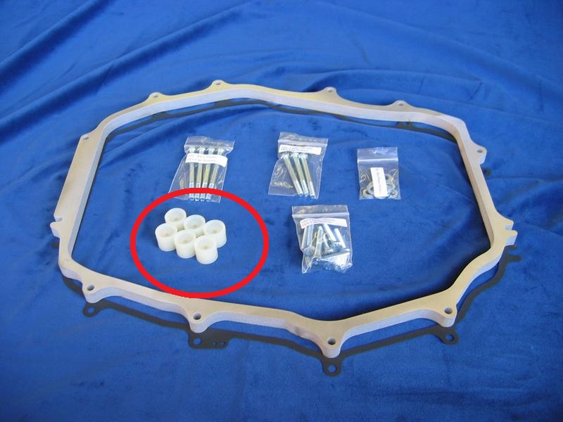

I installed my plenum spacer and the bypass coolant, when I went to try to reset the ECU I hear a clicking sound everything I hit the gas. Also when the car is running I hear a knocking sound. Can somebody help me, please.

Did you add the black plastic pieces into the plenum where the bolts go? Could it be that one of them moved? does it get louder when you rev?

I dislike unwanted noises too! Reread the instructions and start over removing everything. Kinda sounds like one of those center spacers got loose. They would make the noise you describe being sucked down the plenum....Gary

I took my plenum apart and re-installed the spacer from scratch. All good now I dont have the noises any more, thank you for the responses.

I'm pretty sure one of these wasnt sitting properly
Glad you got it fixed
