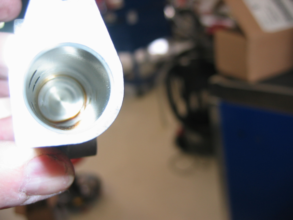

Absolutley agree. For some reason I was thinking the IVT was under the valve cover. Thanks for the clarification I will check it out. This is a pic of the solenoid I presume?

Ok, cleaning the IVT appears to have worked to lose my P0011 code. Previously I had about 2miles on the car after ECU reset before it CEL came on and threw the code. After cleaning the IVT assembly and resetting ECU have gone 6 miles and no CEL. (yay) For those of you with the P0011 or P0021 code here is how I cleaned my IVT. I was thorough and still did it in under 30 mins.
Removed the engine cover, then removed the three bolts holding the IVT assembly on. Disconnected plug and removed bolt holding solenoid valve assembly from the IVT housing. Both parts were really clean to start with but I did use brake cleaner on both, blew them out with compressed air and then lubed both with Marvel Mystery oil. Tested solenoid for function by applying 12vdc before I put it back in the housing and after to make sure all was good to go.
I did blow out the oil ports in the block and made a helluva mess. Put it all back together, reset ECU and so far so good. Thanks to JHatfie for reminding me that fault codes are not caused by always faulty sensors. Hopefully this is a permananet fix for me this time around.
