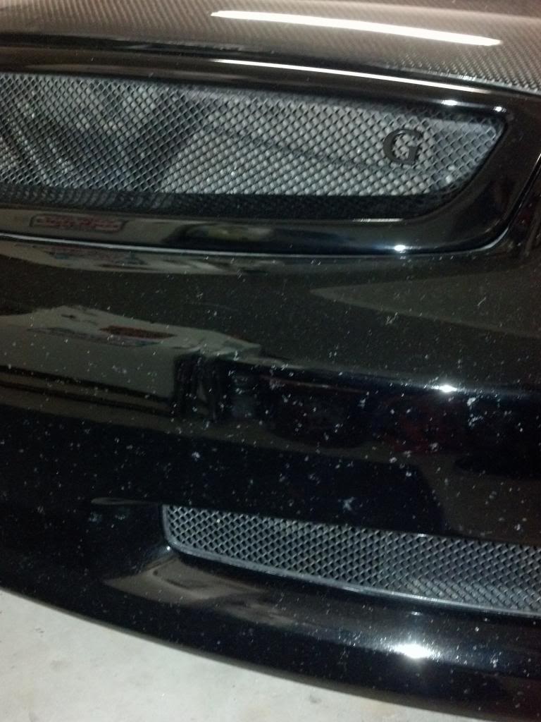

What I did on mine was cut/sand out the holes and glued in the same mesh from my grill. The guys from Ionic here on the forum sold me extra pieces to match. Looks pretty good. Held up almost 3 years now. Ignore the horrid rock chips... that is next on the to do list.

Thats more what I was looking for. How did you mount them behind the bumper?
Old Apr 4, 2013 | 12:09 AM
blackgspot's Avatar
Joined: Sep 2009
Posts: 28
From: frankfort il
I took the bumper off and glued them in with some regular loctite type adhesive. I don't remember what kind but it was white and came in a caulk tube, got it from like home depot. Cut the mesh to fit and just glue it liberally over the mesh so it seeps through it and onto the lip where the old mesh was "attached." Trick is to use enough to get it to stick, and not too much it runs out the front onto the paint. Use some painters tape to hold it in place.
