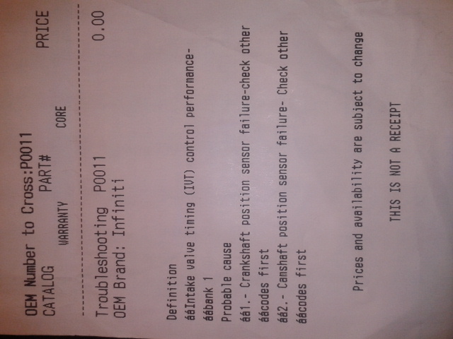

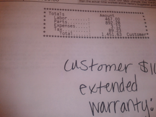

Autozone gave me these two codes and it was for a crankshaft position sensor. I have an extended warranty on the car since i just bought it and took it to the local dealer for the work. Let me say most importantly, significant difference from the 4dr TL i was driving......much more effin fun to drive the G. I had the TL for five years, did some bolt ons, brakes, simple adjustments and tune -ups, a lot of suspension work.....broke stuff, fixed stuff, this is a great forum and hope i can help here too. The dealer came up with:
1. Both Valve Assembly Solenoids
2. Bad O2 sensors bank 1 and bank 2
So it would have been "customer pay" $1,541.63 but with the warranty it was $100. I am by no means whatsoever a mechanic; I don't think the parts are the same and anyone please feel free to explain. I just posted this to help anyone searching codes find a solution.

Uhh dude, $1541 for a crankshaft position sensor? They are $40 at autozone and my mother could change it! At $100 under warranty, you got ripped a new one, boss.
Maybe I misunderstood, what did you pay for?

I paid my $100 deductible for parts/labor on:
1. Both Valve Assembly Solenoids - is that a Crankshaft position sensor?

no where in there, is it indicated a Crank/Camshaft Position Sensors....
the 2 O2 Sensors, and both Valve Assembly Solenoids, I assume these are the timing valve soleniods a little more involved than the Camshaft Position Sensors....
I'd say, 100$ for all that you got a pretty good deal rather than pay all the repairs yourself....

^nah timing valve solenoids is as easy as removing the oil filler cap lol
