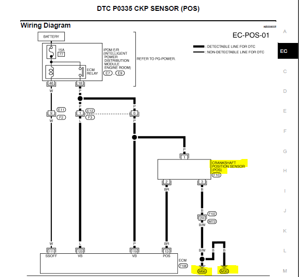

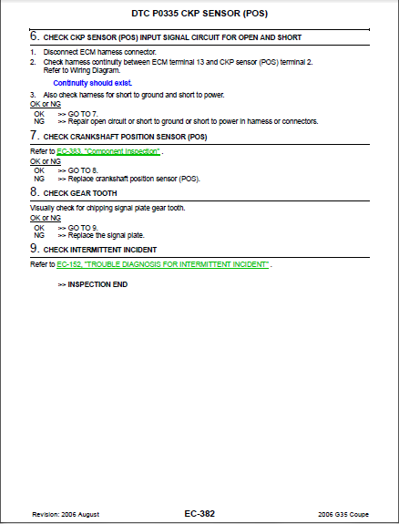

Wow! sounds like you have been hard at work, I feel for you. Intermittent problems are a pain in the A@#. I have attached a couple if diagrams out of the service manual for you. From the looks of it, I believe you definitely have a faulty connection some where in the harness/connectors. There are a couple of grounds that are identified in the troubleshooting (T/S) section that you should consider looking at. I would follow all the steps for ground T/S and eliminate that portion. FYI, the PG section of the service manual shows a detail view of the harness ground connections and the different harness pin feeds. Search for ground M66 or M30 in the PG section, and you will get there. Don't forget to do a really good detail inspection of the Crankshaft position sensor connector for condition and wiring attachment to the pins.
Good luck, its a lot of work, but I know I don't have to tell you that, you've already invested a lot of time.
