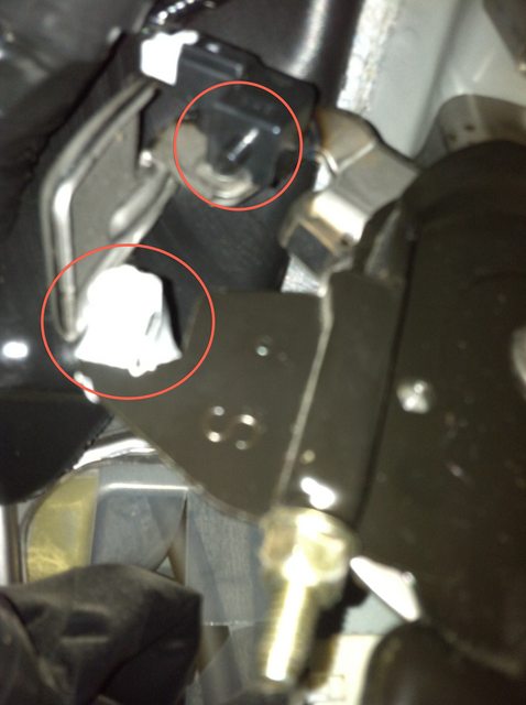

Alright so I finally took a look at the pedal and produced a ghetto $0 temporary fix. The switch/button (top circle) that the brake pedal (bottom circle) hits was jammed (not broken) so when the parking brake was disengaged, it wasn't reaching up all the way to where the button was. So I took a piece of plastic about a half inch wide and duct taped it to the pedal where it's supposed to hit the button. With the extra half inch, it finally hits the button and the BRAKE light is now off the dash when my parking brake is released.
Now I won't have to worry about it until it falls off again, at which point I'll just re-duct tape it again.
