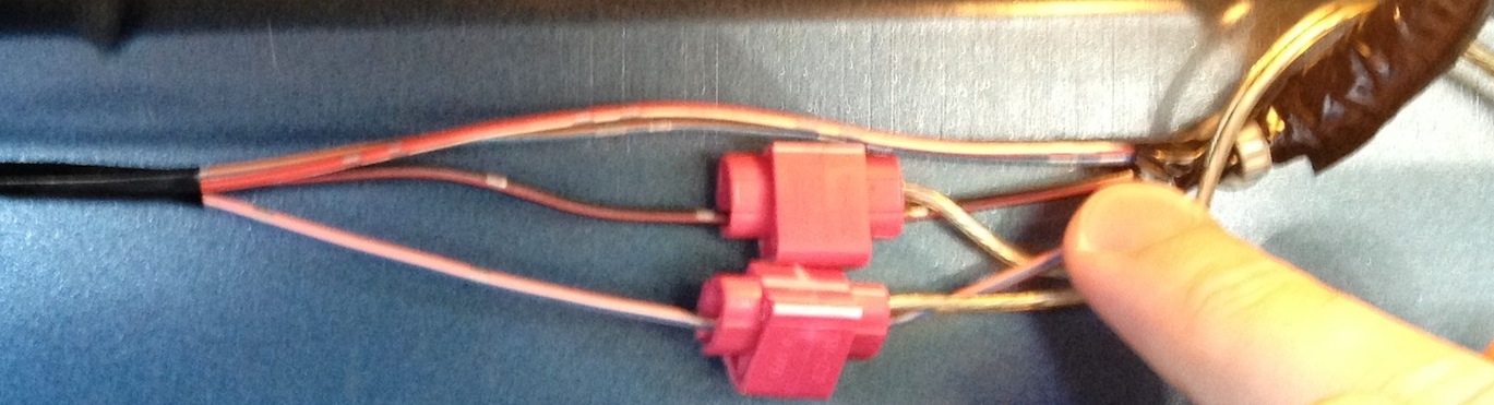

Old Jul 23, 2013 | 07:40 PM
ChiveOn's Avatar
Joined: Jun 2013
Posts: 7
Spliced from the Pink wire with blue line, and red wire with black stripe and grey dashes with some speaker wire.
Clearer pic of the wire colors.
This is in the trunk near the trunk release harness thing. The red and black wires are coming from the non oem spoiler and connected them to the speaker wire with connectors, that way I can unhook the spoiler if I want. Then I just unplugged the harness going to the 3rd brake light cause it looked weird with all them brake lights
Hope this helps.

Thanks for the pictures. It helped me a lot. The brake light works now. =)
