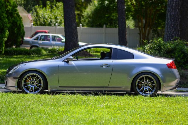

Originally Posted by redg351616
did you have to roll the fenders or anything?
Not needed...Only if you run a semi aggressive set up would you need to roll the rears...This is a pic with the springs im selling, with aftermarket wheels..
