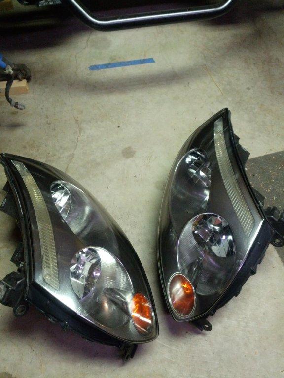

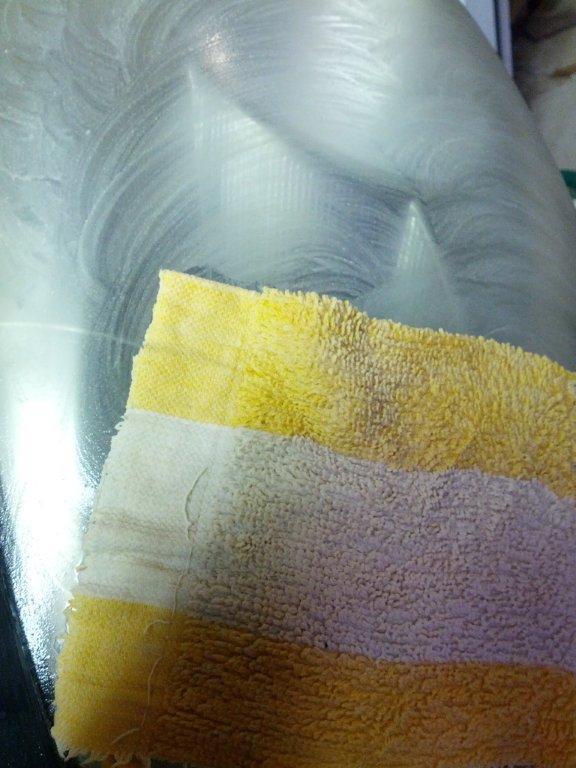

Headlight rehab
OK....last night puttering around in the garage at 10pm....looking for something to do.
Looked at my headlights on the shelf and they look pitiful. Hazing, yellowing ....ughlhgh.
A couple years ago I was building custom pokertables with custome paint on the racetrack.......I used top of the line automotive clearcoat to protect the paint. To take the clear from as sprayed to that super shiny deep paint look I had gotten an array of buffing stuff......
I figure the acrylic of the headlight cover is not that different....so what the heck I have all the stuff.....basically free.
Starting with the heaviest cutting compound with lots of water a terry cloth by hand
Then the swirl remover on the electric buffer sheeps wool pad
Polish 1 terry cloth by hand
Final Polish terry cloth by hand
20 minutes later......done......although some of the surface pits are still there from rocks etc...remember 200k miles.... the dang thing looks like new. Maybe I could go one step back and do wet sanding with 800 grit paper then 1000 grit paper then the 4 steps of buffing to take a bit more material off and get more of the pits out....but really not necessary.
I do think that now the material will oxidize faster than the original because I suspect they treat the outer surface with some sort of coating......however I think I'm going to try some different clear coat wax to see if it withstands the sun and weather better.
but for $0 and a bit of elbow grease I'm pleased with the results.....no big deal to do that once a year.
Any thoughts on a coating to put on ?
Attached Thumbnails -img_20130916_224956.jpg   -img_20130916_224743.jpg   -img_20130916_224715.jpg   -img_20130916_224725.jpg   -img_20130916_230453.jpg

Might I suggest using clear 3m wrap/clear bra to protect those headlights after the work already put into them? I too had hazy headlights and would sand, polish wax them to make them look brand new again but within 6 months they would required more re-treatment....the last time I decided to apply 3m clear overlay to them & its been over a year and they still look flawless. The material wasn't very expensive and didn't take much time to apply.
Its worth looking into if you don't wanna have to repeat the process every so often, plus the material is actually rather thick and helps protect against rock chips etc.

^^^ What he said. Years ago when I refinished my 04 headlights, I wetsanded, polished, buffed, and then threw some 3M over them. They stayed perfect.
