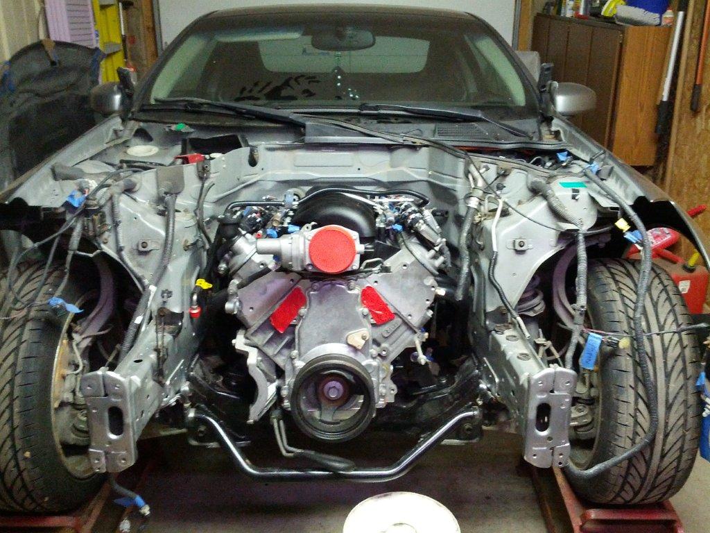

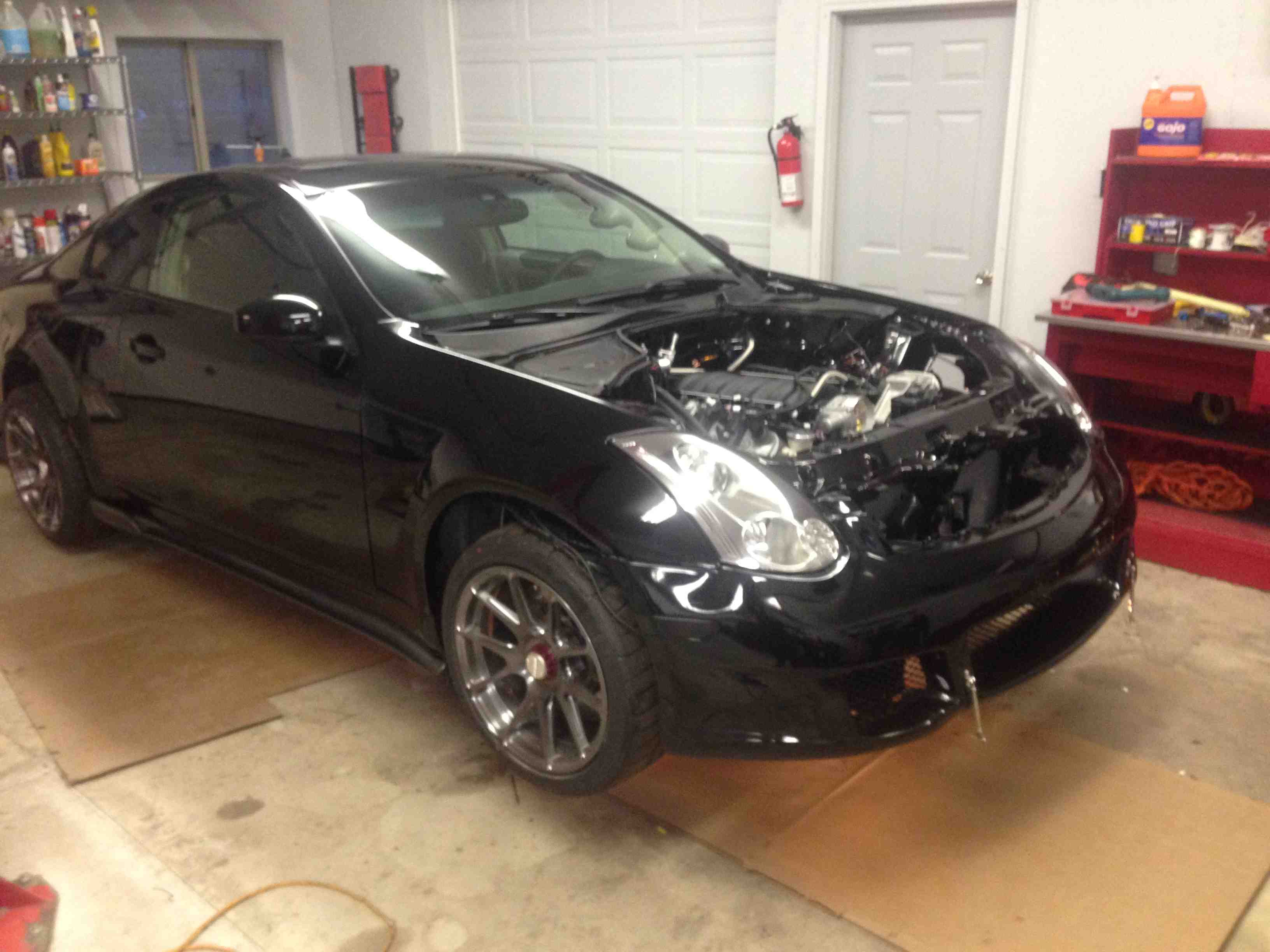

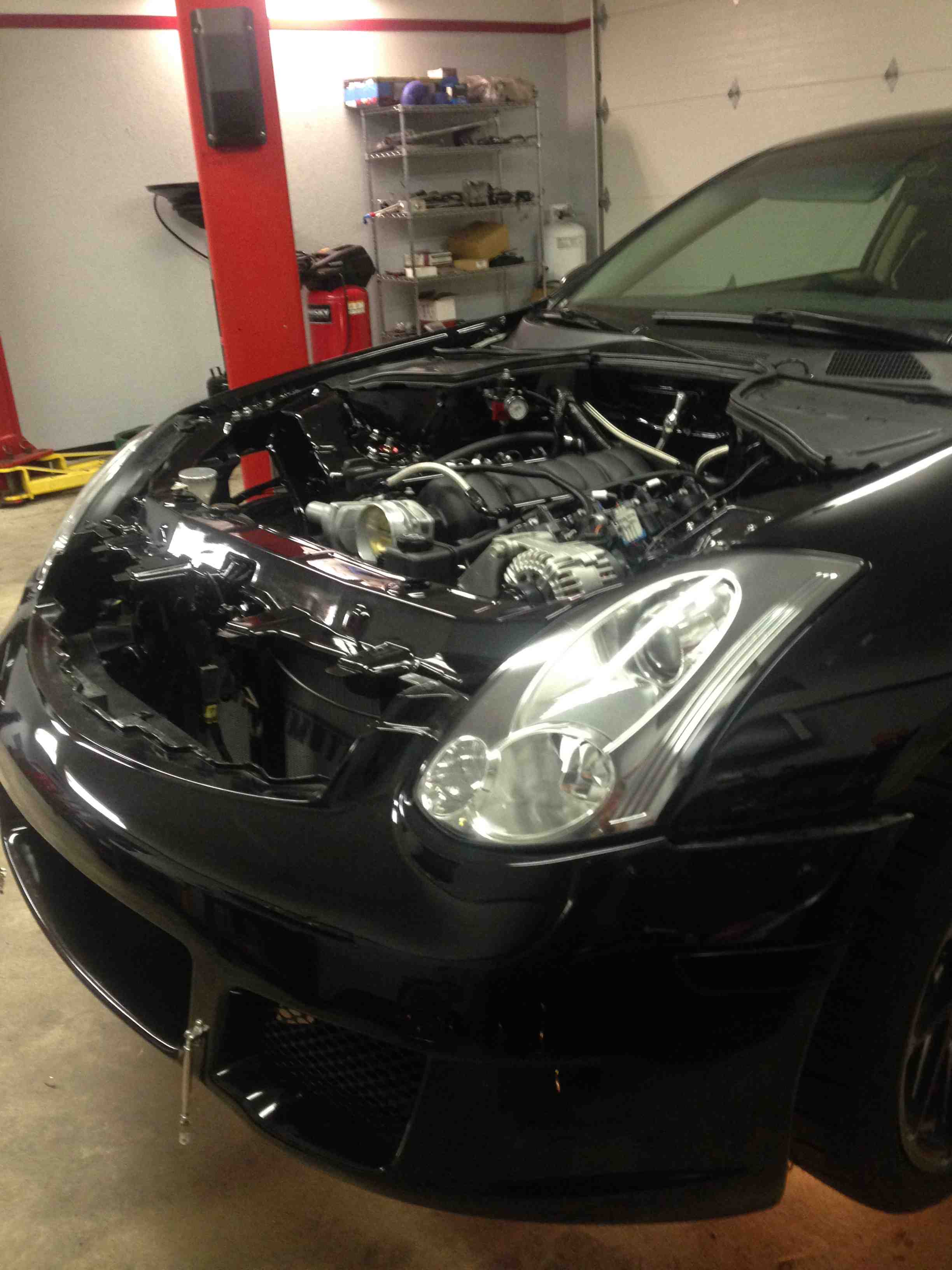

Heres what I did with my LS3.
Also, I fired mine up last night. I know, No video etc it didn't happen... However, you can make up your own mind if it happened or not.
Heres pics of it installed already two days ago. I still have to do my exhaust work (the straight long tube headers are loud) and a better intake custom tube, tuck some wires, and reinstall some interior pieces. etc...
Amazing work! BTW I love the unique Stillen bumper and carbon sides.

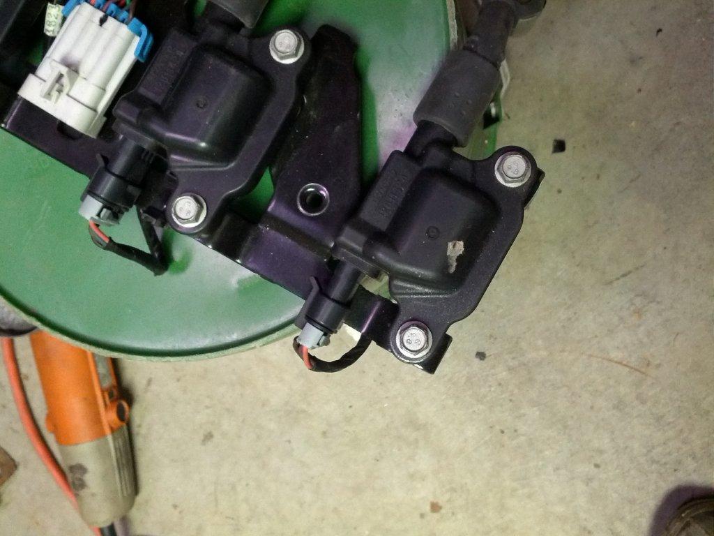

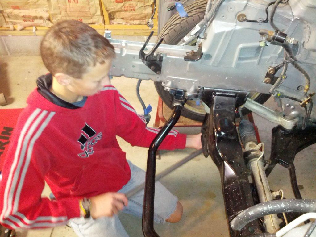

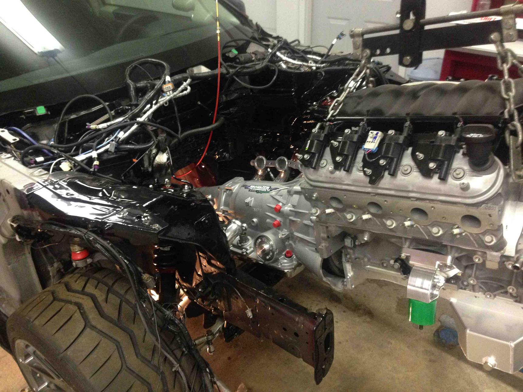

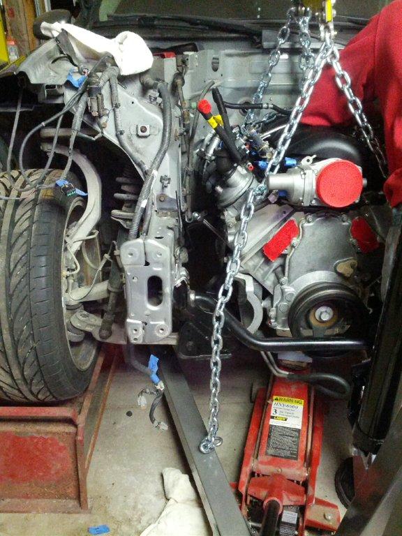

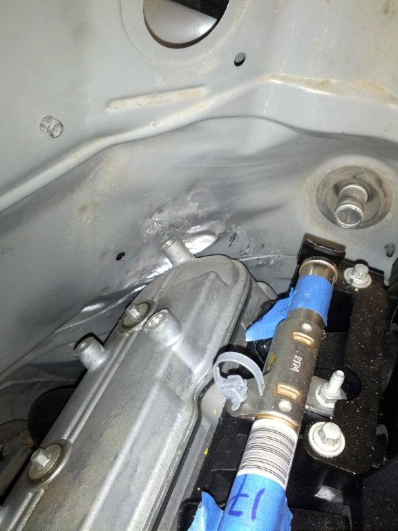

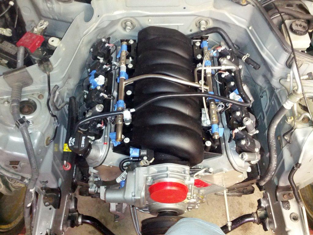

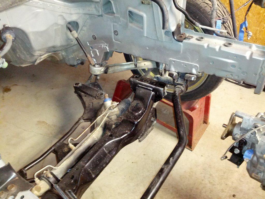

This past weekend I made a bit of progress……Not as much as Stus35 though. This is my first big build and I am forced to spend a lot of time just looking, thinking, learning and researching each step. I was able to get my boys involved again, it’s fun to see them getting excited about the build.
I did have some issue getting the fitting out of the block that the OEM oil cooler connected to. Finally did get the drain plug out but the threads were damaged…..ugh. Looks like the fitting was cross threaded when it was originally put in. The good news is that the aluminum of the fitting was much softer than the block aluminum. I ordered a Chevy Performance drain plug #809-11609289 direct from my local dealer and inserted it the next day….whew the threads in the block were buggered up a bit but the plug found the threads and went in fine. With that completed I could mount the motor mounts to the motor in preparation for motor install.
The instructions for the Fueled Racing kit call for dropping the cross car beam so the oilpan clears the steering rack. I Removed the 4 nuts on the crosscar member, 2 nuts from the lower control arms, and 4 nuts from the support. With the nuts off the shocks push the entire crosscar assembly down and out of the way. I lined up the engine/transmission and inserted the headers from below before bringing up the crosscar assembly. I inserted the mount bolts (nut and washer is a real PITA to line up and get started from inside the crosscar beam. Then with my floor jack under the crosscar beam and the hoist still in place I was able to raise the engine assembly and get all the bolts to line up……took a little finesse between the hoist and the floor jack. Reassembled all the fasteners. Now I’m in the process of checking all the alignments and clearances. Headers and bellhousing seem a bit tight on the driver side…..Headers are also too close to the stock fuel lines on the passenger side where they enter the engine bay….Fuel lines will need to be re-routed…I am having some issues with the trans mount bracket as the transmission mounting location does not match with the transmission that I have. I talked with Todd at Fueled Racing and imagine we will get that sorted out this week.

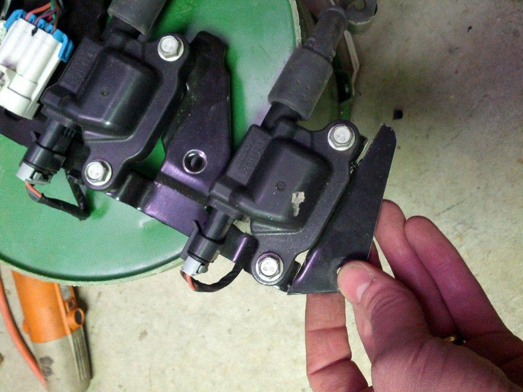

The rear coil pack on the passenger side interferes with the false firewall. I Massaged the area sheet metal, trimmed the coil pack bracket and the post on the valve cover to get good clearance. Not beautiful, but I now have the clearance I wanted.
Attached Thumbnails -img_20131109_152619.jpg   -img_20131109_160924.jpg   -img_20131109_214803.jpg   -img_20131110_011424.jpg   -img_20131110_011439.jpg
